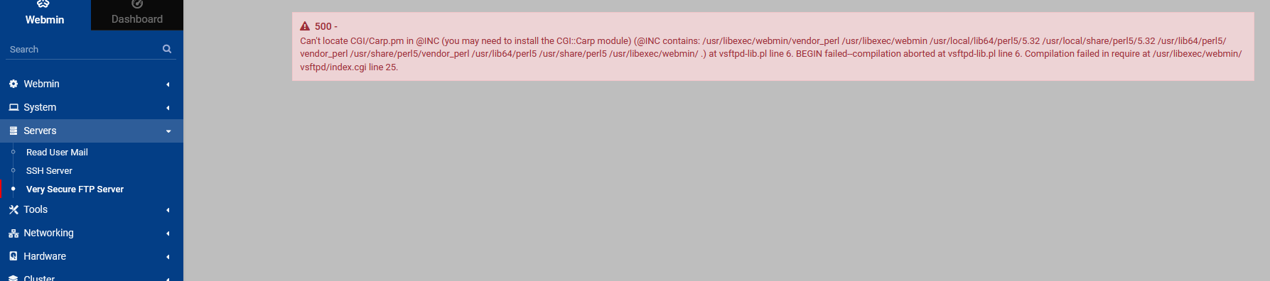

I get a different error after install onto almalinux 9, install went fine but getting these error.
I’ll have a play later.
That’s a Perl module you can most easily install from the system package manager.
Ok, I used dnf install perl-CGI and seems to all working.
OK, then it’s something wrong with OPs system. But, it’s not the OS version (you’re using AlmaLinux 9, too…all 9.x versions should be the same in this regard).
