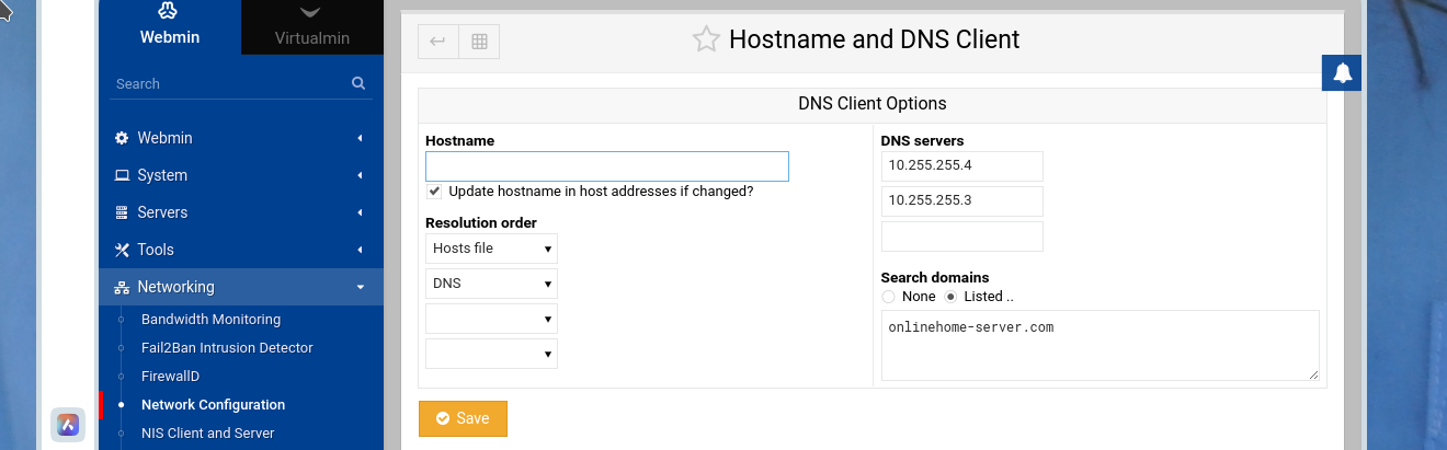

If you edited the /etc/resolv.conf by hand you may want to go to this page and make the changes so they stick on reboot. Not sure if you have them configured static or not.
