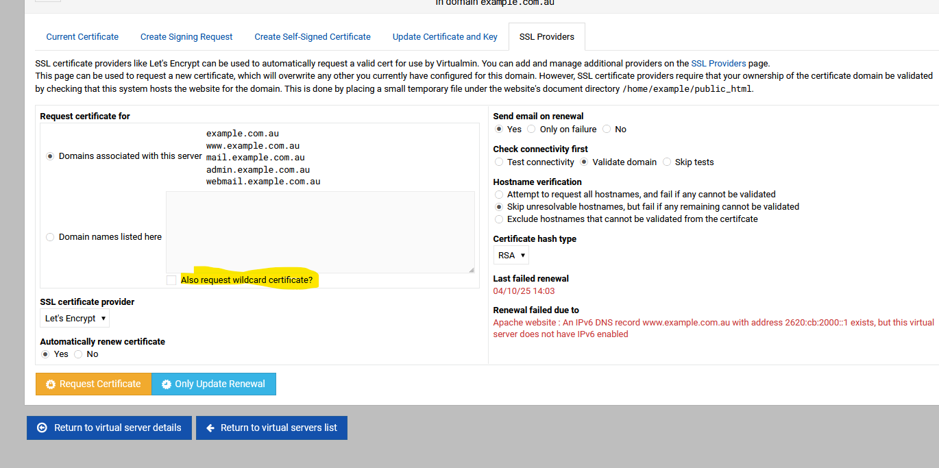

This May Be A noobe question but im trying to setup wildcard for my domain when simply doing a standard ssl renew or request new its fine but if i click add wildcard i get this error i have used mysite instaead of my domain

@paccione for Virtualmin to support wildcard certificates, it needs to manage your DNS. We don’t yet support GoDaddy DNS, which is why it fails.
@Jamie, maybe we should add that as a Pro feature too, since GoDaddy is very popular.
@paccione You see the checkbox in the “Manage Virtual Server ⇾ Setup SSL Certificate / SSL Providers” page only because the “DNS for domain” feature is enabled in the “Edit Virtual Server” page. However, it just creates local DNS records that don’t interact with the outside world because you’re hosting your DNS at GoDaddy.
