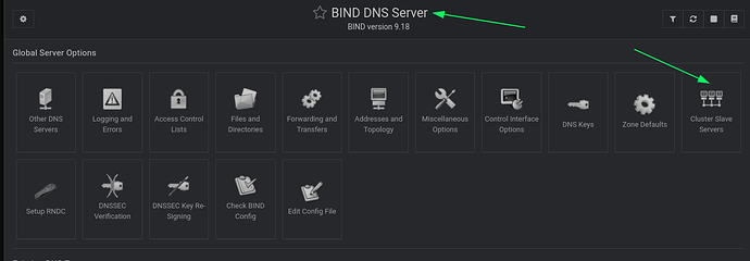

No cluster webmin dns servers there is an option in the bind module you don’t need to use any of the other cluster options at all
