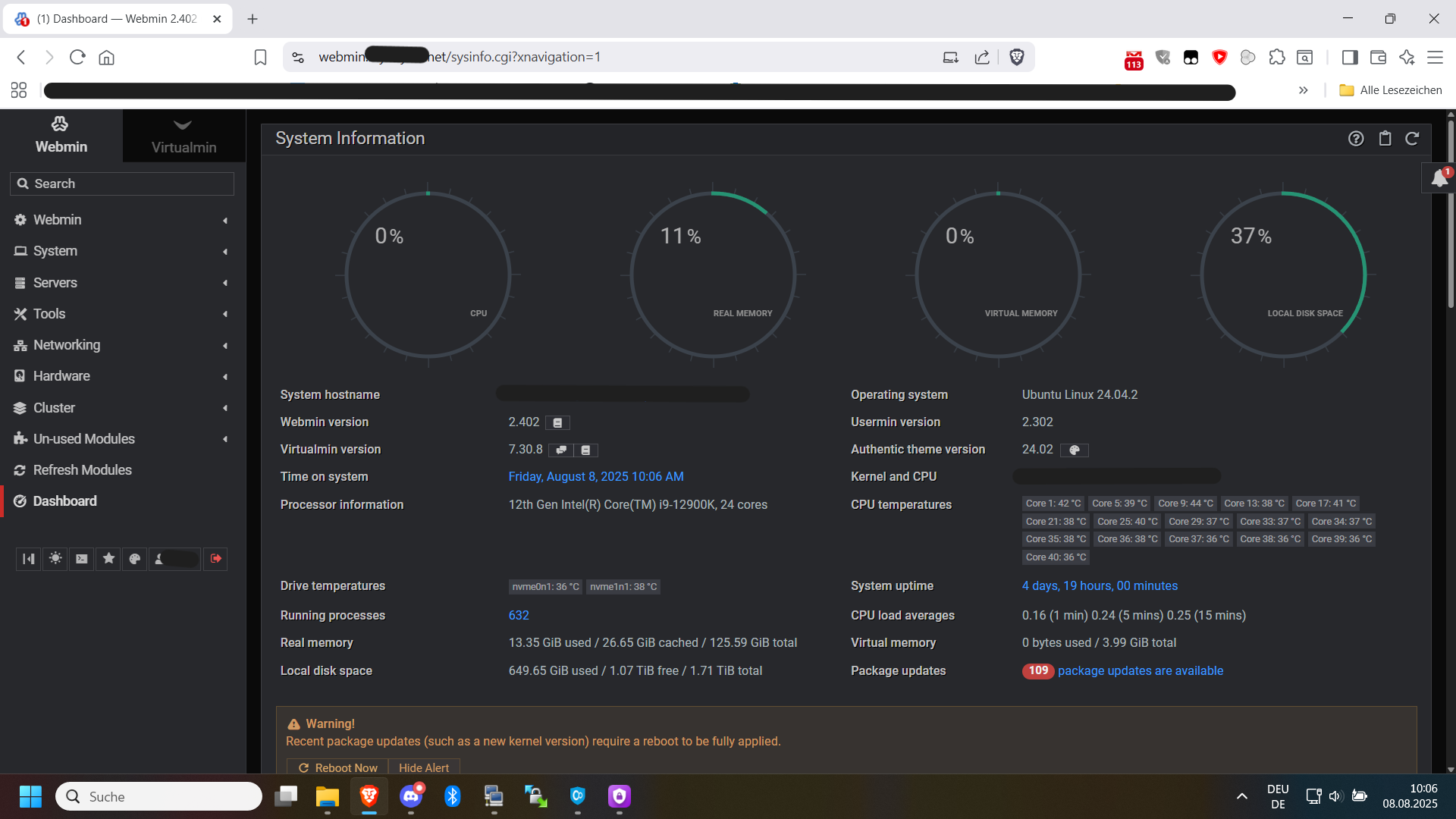

The issue is, I have other Nginx configurations that I have outside of Virtualmin (For example webmin and a software panel application) and all of them stop being accessible when the Virtualmin configuration is applied.

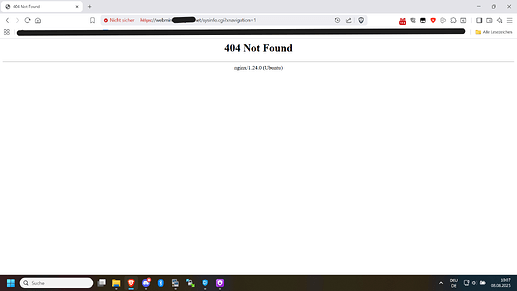

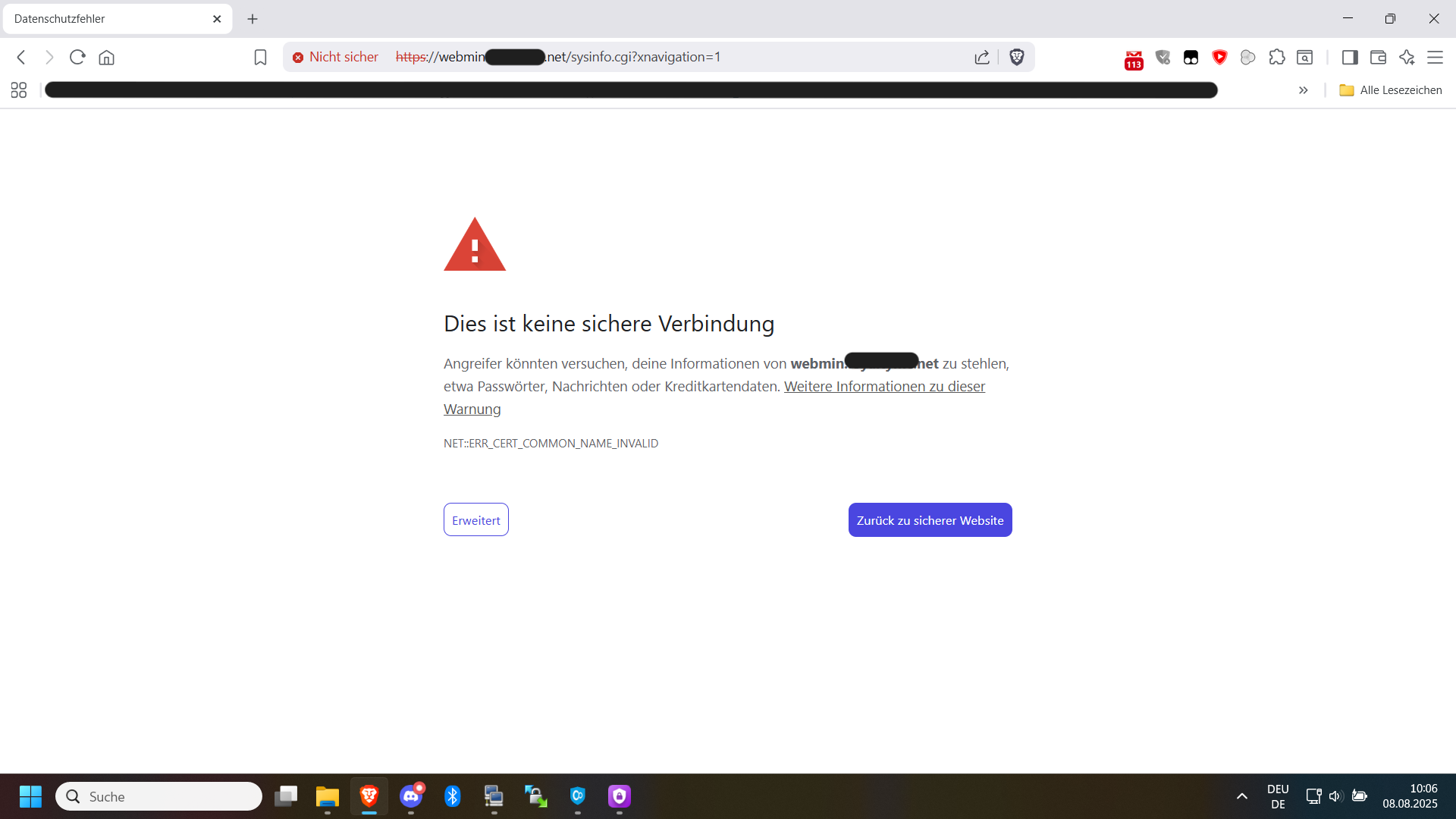

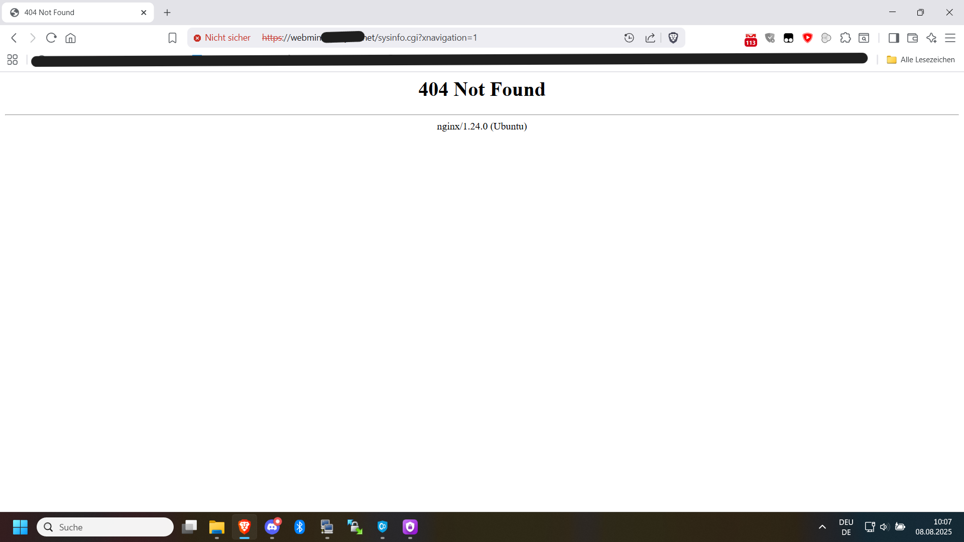

As for what happens, it says that the certificate is invalid and instead of bringing me to the Webmin dashboard like it should do, it redirects me to the main website on port 80.

My apologies for the delay. I have been busy the last few days and had to put this issue to the back of my mind. As for the invalid certificate, it says ERR_CERT_COMMON_NAME_INVALID, but ONLY if the Nginx config from Virtualmin is active. Furthermore, it doesn’t display the dashboard anymore. I have uploaded images below to show the situation:
So, the cert is for the wrong name, which indicates a problem in your nginx configuration (the cert you’re trying to use for this is not for this name). Are you actually requesting a certificate for webmin.domain.tld? Since you configured this yourself, Virtualmin has no way to know to include that in your Let’s Encrypt requests, you’ll need to add it (or manage certs for these webmin domains yourself with certbot, but Virtualmin can be configured to do it).
