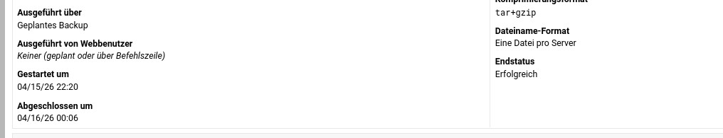

Two scheduled backups (April 1 and April 15, 2026) were created successfully without any errors. However, when restoring, the database was missing most of its data.

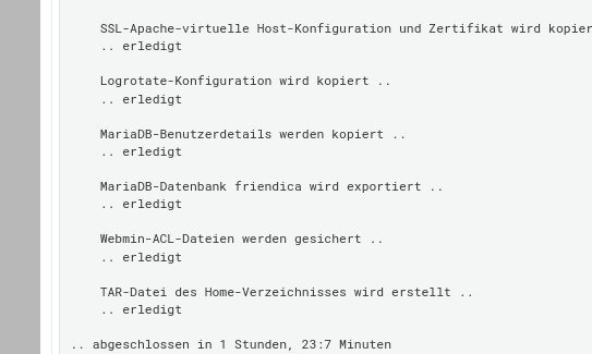

The MySQL dump file is about 3.1 GB in size, so it’s not empty - it just stops after certain tables.
What I’ve checked:
Both backups (April 1 and April 15) show the exact same set of 22 tables - the cutoff point is identical
No errors appear in the backup logs

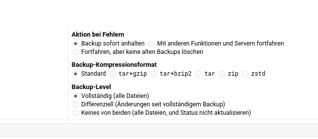

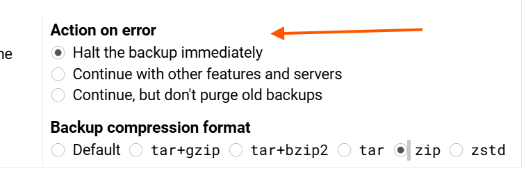

i think the database dump is one of the last items backed up (i might be wrong).
if it is and there is some other interruption in the process
then it might well depend on the “action on error” setting.

I wasn’t able to find any meaningful errors in the logs that pointed to the root cause. Cloning the system for troubleshooting wasn’t straightforward either.
