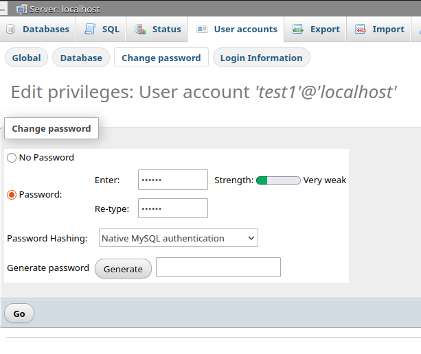

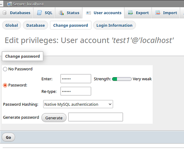

As of now, workaround is that, I login on phpmyadmin using root and changing password after selecting user as showing in below image ( and yes I am using same password which I used while creating virtualmin domain) and works fine.
I am still not getting exact issue if someone here can enlighten something on my issue.

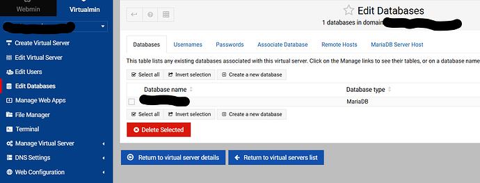

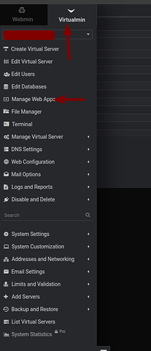

Let’s be clear “Manage Web Apps” is under Virtualmin
in the tab above that you can “Edit Databases” to see the username and password “credentials” - they are of course MariaDb credentials.
