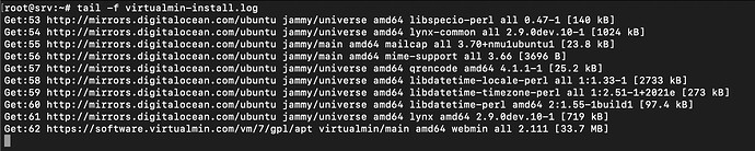

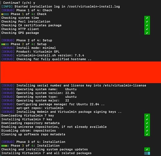

here’s the screenshot of the installation progress:
and here’s the screenshot of the virtualmin-install.log:

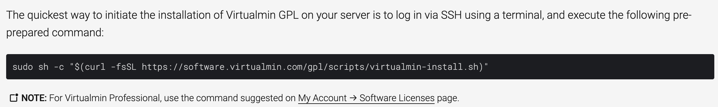

Not sure where you getting that extra commands from.
Did you read the docs?
Simple install
extra commands at
Also I don’t see any errors. Or is it just pausing at that last line?
The extra commands I added supposed to install using LEMP bundle with minimal installation setup and verbose logging enabled right? and yes, the installation is pausing at that line (Get: 62 blabla) for a long time (almost an hour), so then I cancel the installation process.
I also tried simple install following the step from Downloading and Installing:
The simple install unfortunately also didn’t work, getting the same issue (pausing at that Get: 62 blabla). That’s why I came up with the extra command trying to install with minimal build, lemp and verbose loggin to see the logs but still no luck.

What is logged to virtualmin-install.log file? Have you tried running the following before installation and seeing if it works in the first place?
apt-get update
apt-get upgrade -y

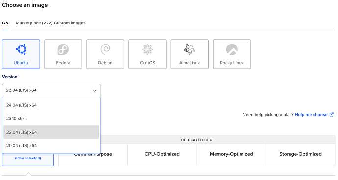

Furthermore, is this clean minimal installation of Ubuntu 22.04?
Or, is this one of the DO “Marketplace/Paperspace” droplets.

I think this one is DO’s ubuntu minimal install image, I choose the os from the image selection below:

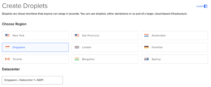

May I know which region you selected before creating the new instance? Mine was not working in SG Datacenter1 region

Trying to recreate this … SG - Datacenter 1 is not available to me - what country is SG?
it’s Singapore with Datacenter 1 -

SGP not SG for clarity
ah yes you’re right, I mean SGP (Singapore). Sorry for that :v:
Sure, here’s the virtualmin-install.log file -
virtualmin-install.log (15.2 KB)
There is nothing evidently wrong in the log. What if you manually try to install the packages that are denoted in the log?
Yes, the log look like the installation process working fine but what happens is that it never completed. Being stuck in this process Installing Virtualmin 7 and all related packages for more than 2 hours now. And I don’t think manually installing the package is a best solution to this problem. I’ll switch to another provider for now. Thanks.
