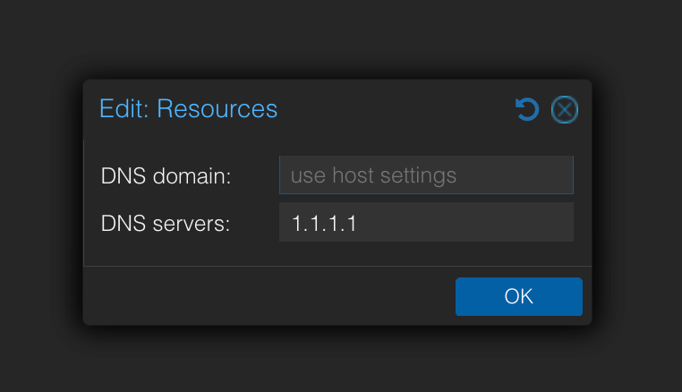

it is fixed. in Cloud-init DNS domain i wrongly put the dns 8.8.8.8 instead of using the domain. i clearly missed it and typed two dns 8.8.8.8 1.1.1.1
