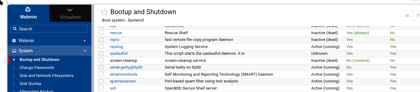

SSH was not updated, I try first activate the server with the run command in the Server Status widget, finally I need to restart manually the service.
Today I need to restart the VPS and the SSH server is running fine.
