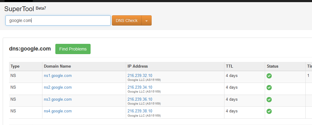

Its a pretty standard method, check google.
