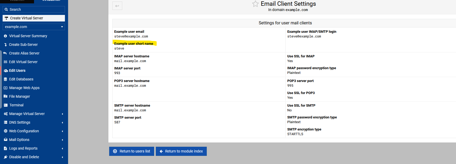

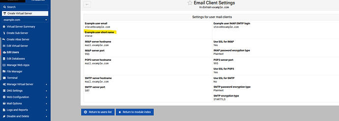

It should work right out of the box, if you use the username exactly as shown in the Username field on the Edit Users page for your domain. If you’re using the default username format of user@domain.tld, you should configure your mail client with a username of literally user@domain.tld (not just user, with the expectation that someone somewhere will add the domain name you’re connecting to).

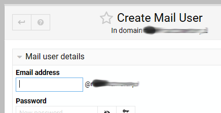

I could be doing something wrong, but I don’t see how to make the short name, I am selecting the virtual server I created and when I click “add email user” (or any other user as far as I can tell) Virtualmin adds the domain on its own (and username@my.domain is what lands in both users and shadow files).
But I don’t think short names would work in general, as of now I have one virtual server, but I want to host 4 domains and assign emails to them separately, so some mechanism of differentiating between feedback@firstdomain and feedback@seconddomain will be necessary

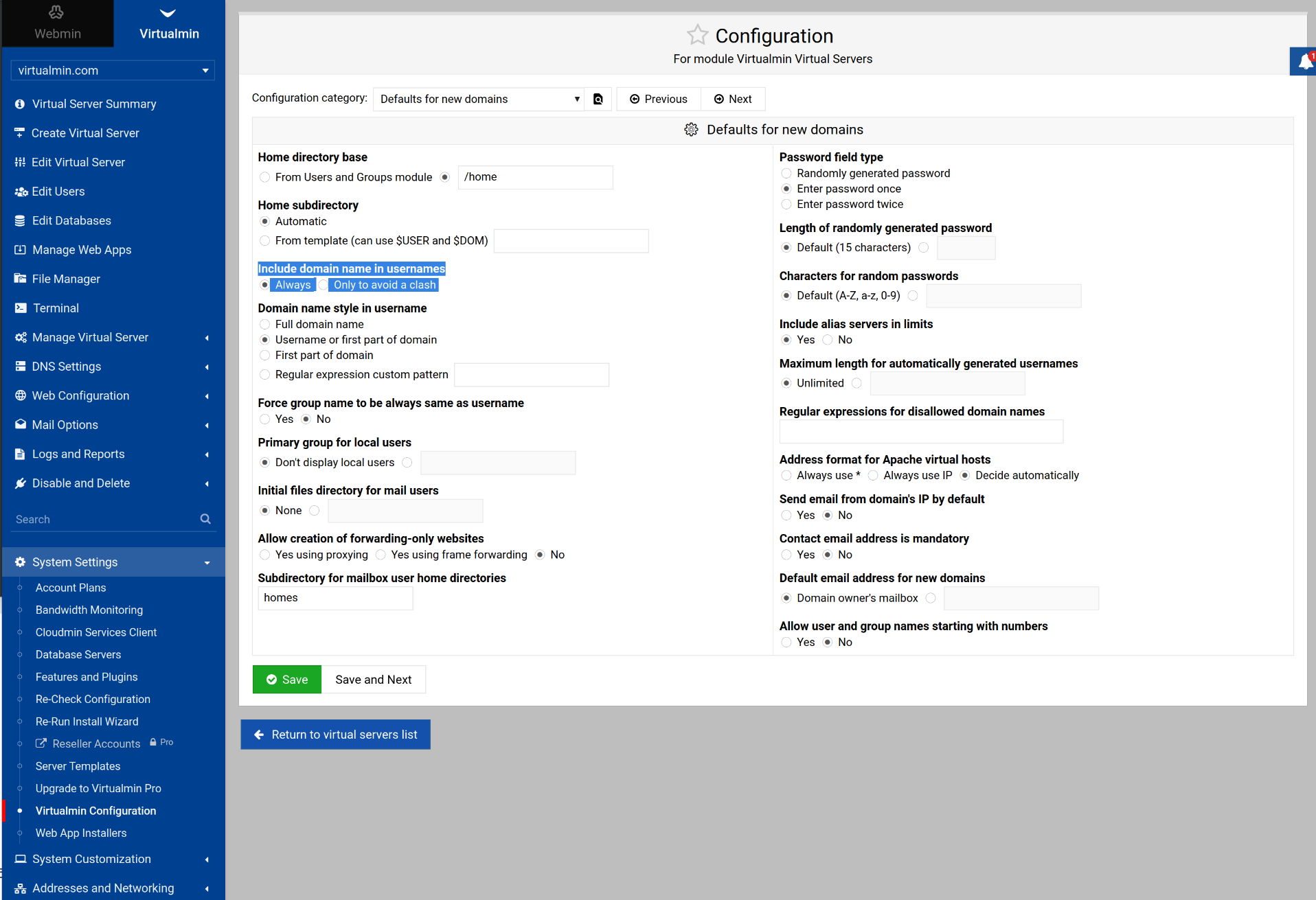

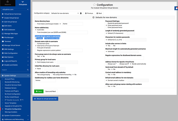

If you’re only hosting one, or a small number of friendly, domains, you can change the username format to not include the domain name in Virtualmin Configuration if you prefer it.
Because these are real system users, that would mean you can’t have a webmaster in two different domains without at least one of them being further qualified by something (adding domain name is how Virtualmin qualifies clashing names).
Probably not great advice even though it’s true. Have even 2 domains and there is a high chance that there will be two admin@ addresses and so on.
I found it better to just make it a hard rule that everyone uses their full email address.
I think I was extremely clear about the implications of choosing to not include the domain name in all users. :man_shrugging:
