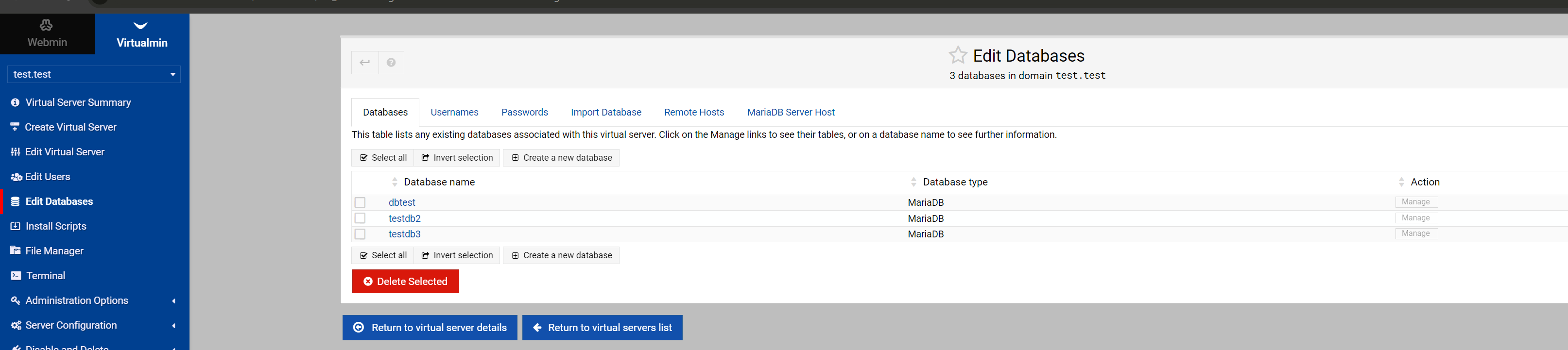

i first created a test virtual server, and made 3 databases associated to it

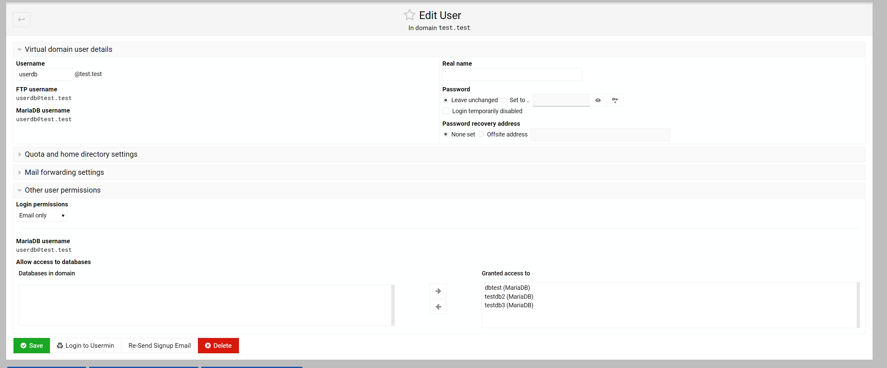

i then created a new user trying to give permissions to the testdb2 database
# virtualmin create-user --domain test.test --user userdb --pass test --mysql testdb2
User userdb@test.test created successfully
this granted access to all databases in the virtual server, not just the one specified.
