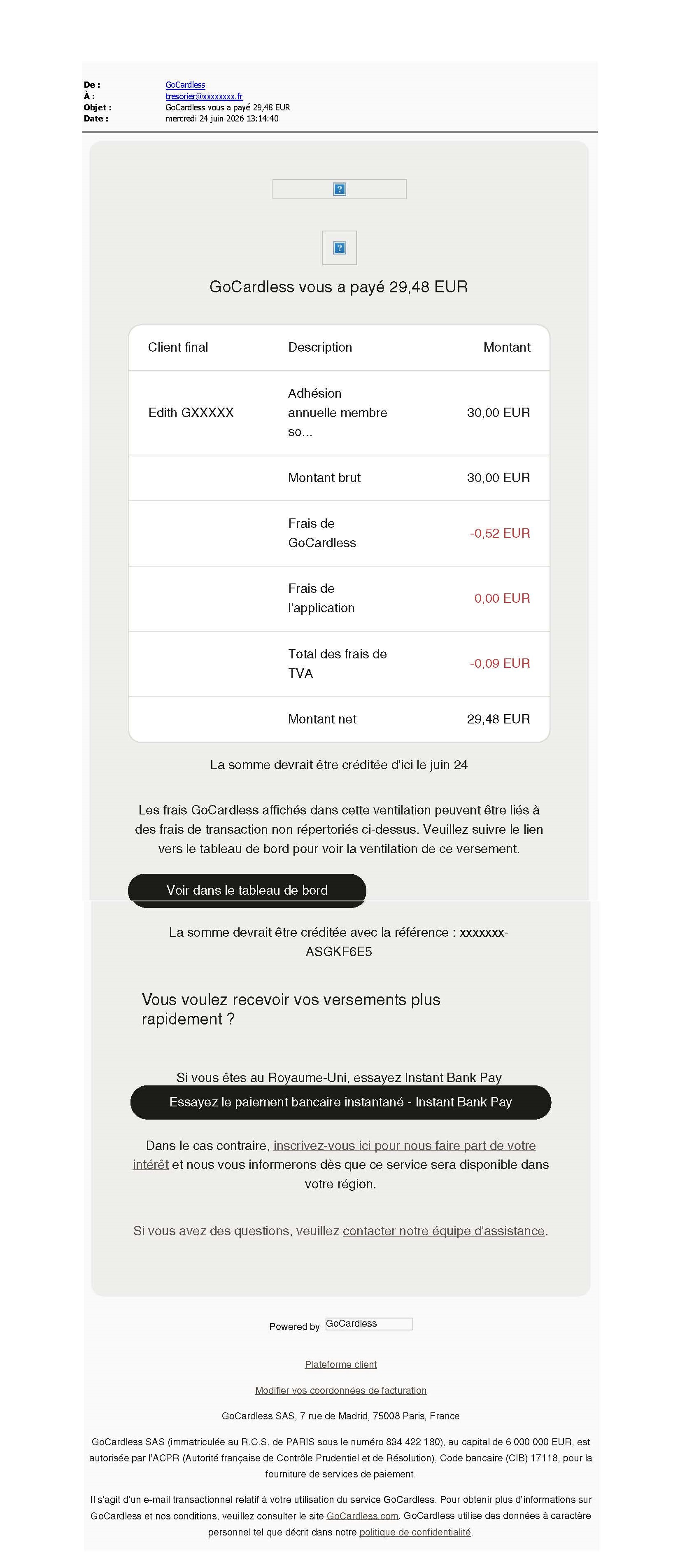

Hello. No, gocardless.com is the domain that sent the email; it was successfully received in the tresorier@xxx.fr mailbox but was not forwarded to the @gmail.com and @hotmail.fr forwarding addresses.
The email arrives in the inbox fine, but it isn’t forwarded to the other email accounts.
This is the error message I found in the log.

Here is the email from GOCARDLESS.

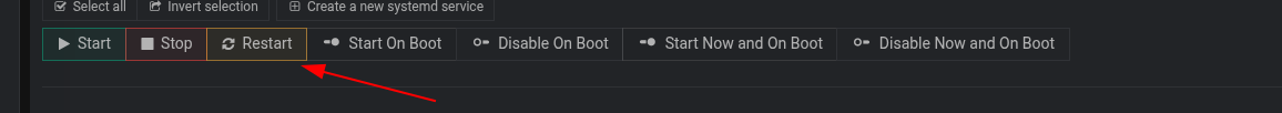

How do I restart opendkim?
as you use Ubuntu, use the following command in a terminal
sudo service opendkim restart
you could also use
webmin → System → Bootup and Shutdown
search for OpenDKIM Milter, check it then scroll to the bottom of the list and press this button
