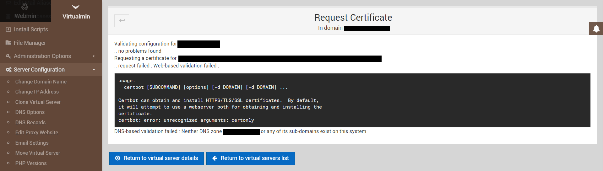

I now get this error:

This is what I get using the proposed work-around when not requesting a wildcard cert:
This is the log file:

What do you set on the previous page? Can you share the screenshot?
Regardless of what I set, the outcome is always as above.
Oh, wait, you are not adding $@ to the end of the script line, to pass the other arguments from Webmin core?
certbot --dns-cloudflare --dns-cloudflare-credentials API-Key $@
I now traced down the problem why it is not working. It is now simply passing too many arguments to certbot (mainly the concomittant use of ââdns-cloudflareâ and â- a webrootâ). Any idea how to fix that?
ââagree-tosâ, ââdns-cloudflareâ, ââdns-cloudflare-credentialsâ, âSOME_PATHâ, ââregister-unsafely-without-emailâ, â-aâ, âwebrootâ, â-dâ, âexample.tldâ, â-dâ, âwww.example.tldâ, â-dâ, âmail.example.tldâ, ââwebroot-pathâ, â/home/example/public_htmlâ, ââduplicateâ, ââforce-renewalâ, ââmanual-public-ip-logging-okâ, ââconfigâ, â/tmp/.webmin/SOMENUMBERS_letsencrypt.cgiâ, âârsa-key-sizeâ, â2048â, ââcert-nameâ, âexample.tldâ]
