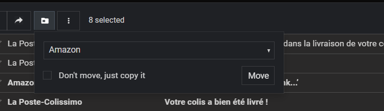

If I hit the move or copy button I just go up one level. Not even a choice on what to do as far as I can tell.
As I click move or just copy it seems to go through the process of doing it but nothing gets moved or copied. Bug maybe, more than likely my fault though.

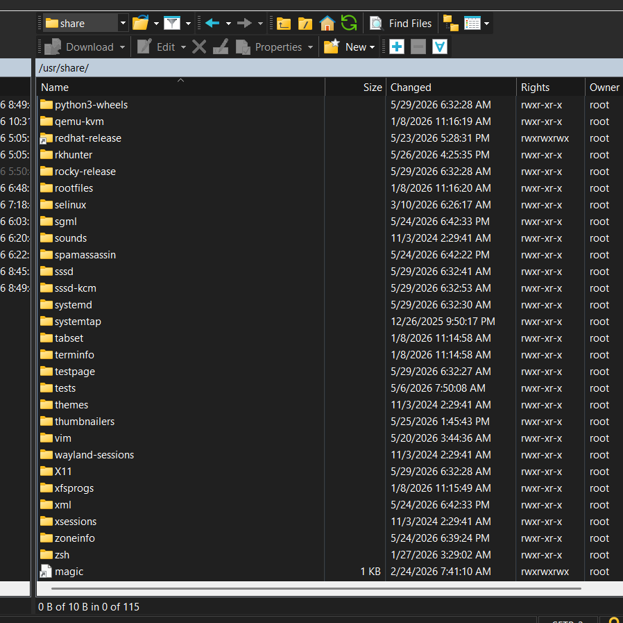

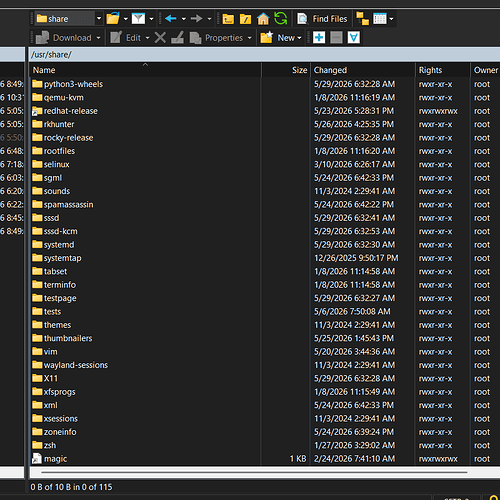

Hi Ilia, the second and third commands I get …
cp: cannot stat ‘/usr/share/webmin/mailboxes/boxes-lib.pl’: No such file or directory …
No /usr/share/webmin folder, that sounds serious.

I chose a folder that I created but get this …
Guessing that is normal?
