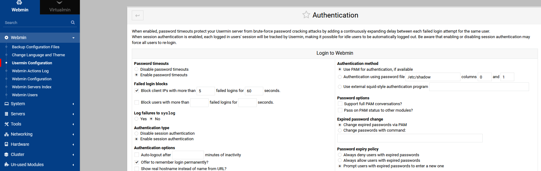

Sounds like fail2ban, can you ssh on?
Ok there is a usermin block on failed attempts, try turning that off

I marked Stefan’s reply as Solved as it showed me where the settings for this are, so I can now understand it.

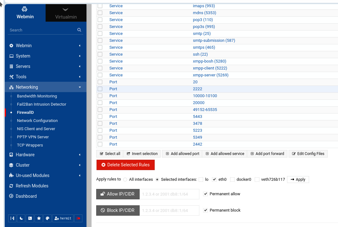

Recently added was an ‘allow’ to get the address quickly back into service.
This was an email address, not a port address, but thanks anyway.
If you did an ‘allow’ on 65.181.14.69 the user would bypass fail2ban.
This is usermin’s own flood check and nothing to do with fail2ban
