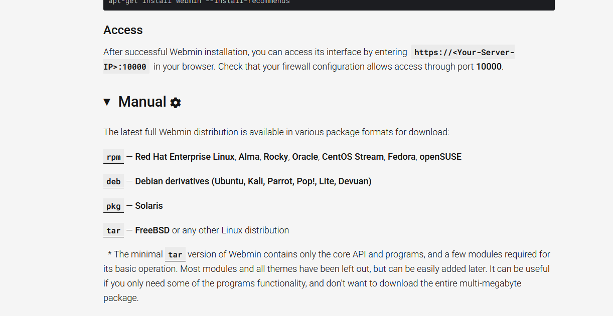

Under manual section
Oh, yeah, I’m not seeing a problem, either. Presumably a temporary SourceForge problem.

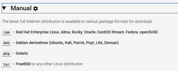

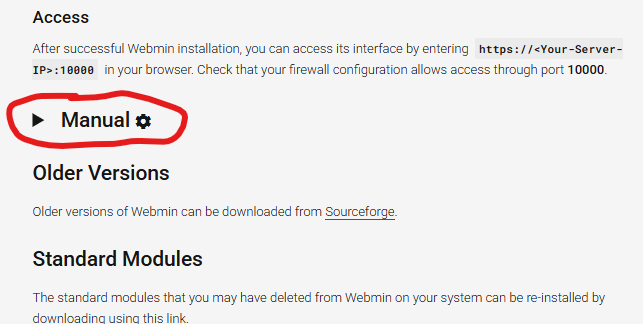

Same here, no errors now, so it was a temporary glitch I stumbled upon. Nonetheless, if you are inclined you might consider not hiding the four manual installation options like this:
It doesn’t save much screen real estate and I didn’t realize I needed to click the triangle, especially since the mouse cursor changes into a magnifying glass typically used for images and frankly I thought it had something to do with “Older Versions” which I had no interest in.
