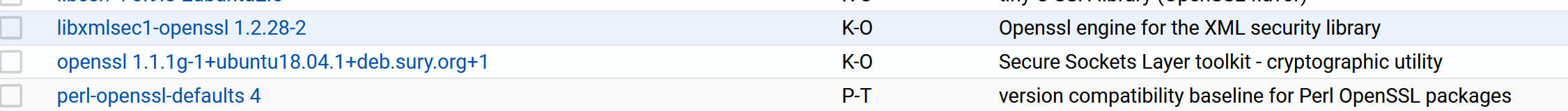

The version of OpenSSL that I have installed on my server is 1.1.1.g, as can be seen in here:
I contacted them telling that that should be a False Positive, but they say that the vulnerability for OpenSSL comes because all OpenSSL editions for 1.1.1 and below have reached their end of life. And that it is recommended to update to OpenSSL which is currently receiving security updates, or provide verification that your OpenSSL is receiving extended support from a reputable source.
