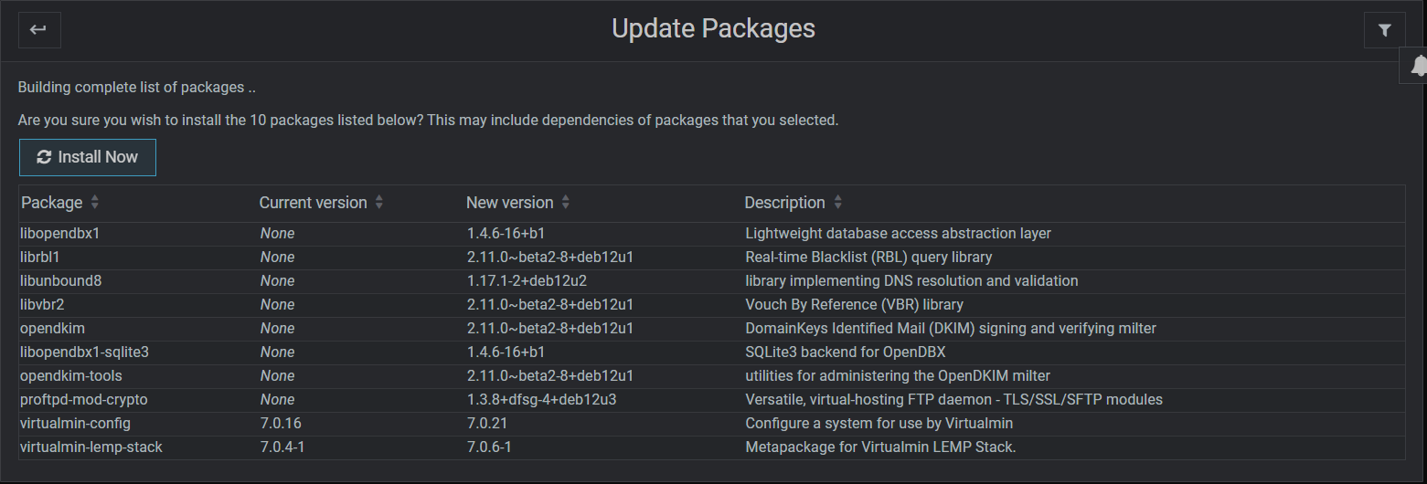

When I try to update virtualmin-config virtualmin-lemp-stack from Webmin menu, they want to install other packages too:
I’ve read that one of these packages was wrong and wanted me to install Apache over Nginx before but it got fixed. However since the fix some packages are still left which want to get installed.

only these two want to get installed and the ones which can be seen on the screenshot not.
Do the new packages needed or not? What is the correct way of installing these?

This is all good and very much expected. We added the opendkim package to the list of recommended packages for full LEMP/LAMP stacks.
Thank you for reply!
Then I will install all of them.
Yes, as long as it’s version 7.0.6 and not 7.0.5, and Apache isn’t installed as a dependency, it’s all good then!
