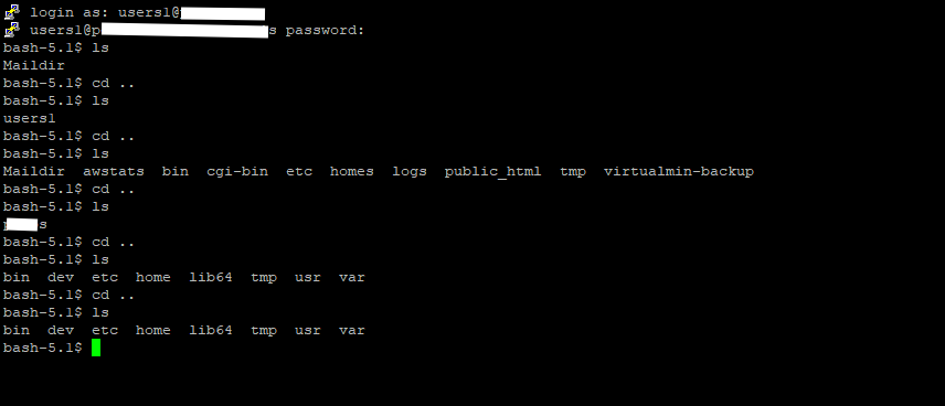

So, I am having an issue with Virtualmin regarding jailkit. I made a virtual server with a user that is supposed to be able to login to SSH. But the issue is, I don’t want him to have access to all files. Currently the user can cd outside of the home directory and read files, but I want to contain the user to his home directory. I read that there should be an option called “Chroot jail domain Unix user?” somewhere, but I can’t seem to find it. Any help would be appreciated

I tested a dev machine, you can get past /home (for a user, not domain owner)but it limited and I guess its for the limited commnds the user can use correct?
