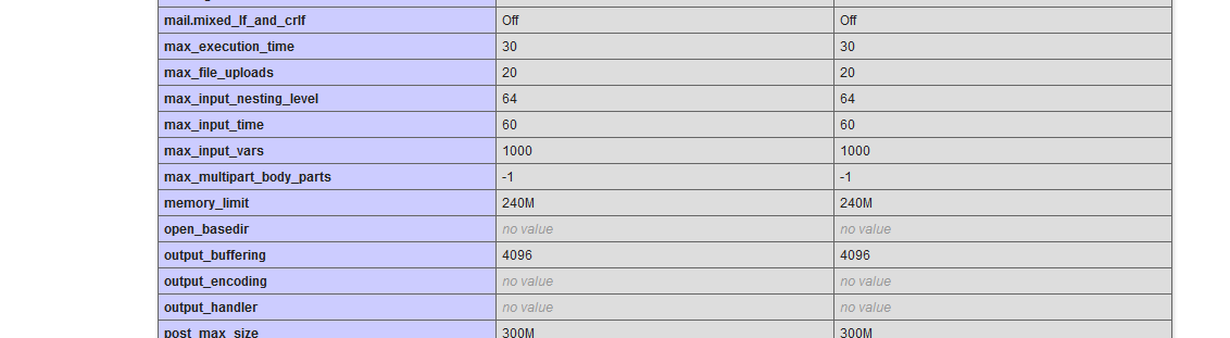

No I did not set specific php memory (just left as is) so no idea where?
I think I may have found this in Webmin -> PHP Configuration -> /etc/php/8.1/fpm/php.ini and set it to 240M, but that didn’t seem to alter anything on the precheck

You did restart fpm ? If not restart it. The missing modules are really useful in a php environment but are not installed by virtualmin by default, but there is nothing nasty there
you can set per Virtual Server here

Oops! silly me! :blush: Done now and install passes that memory check.
