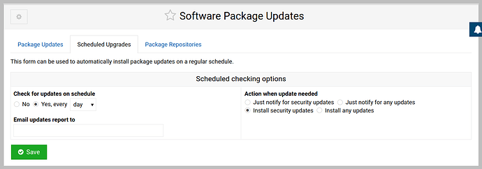

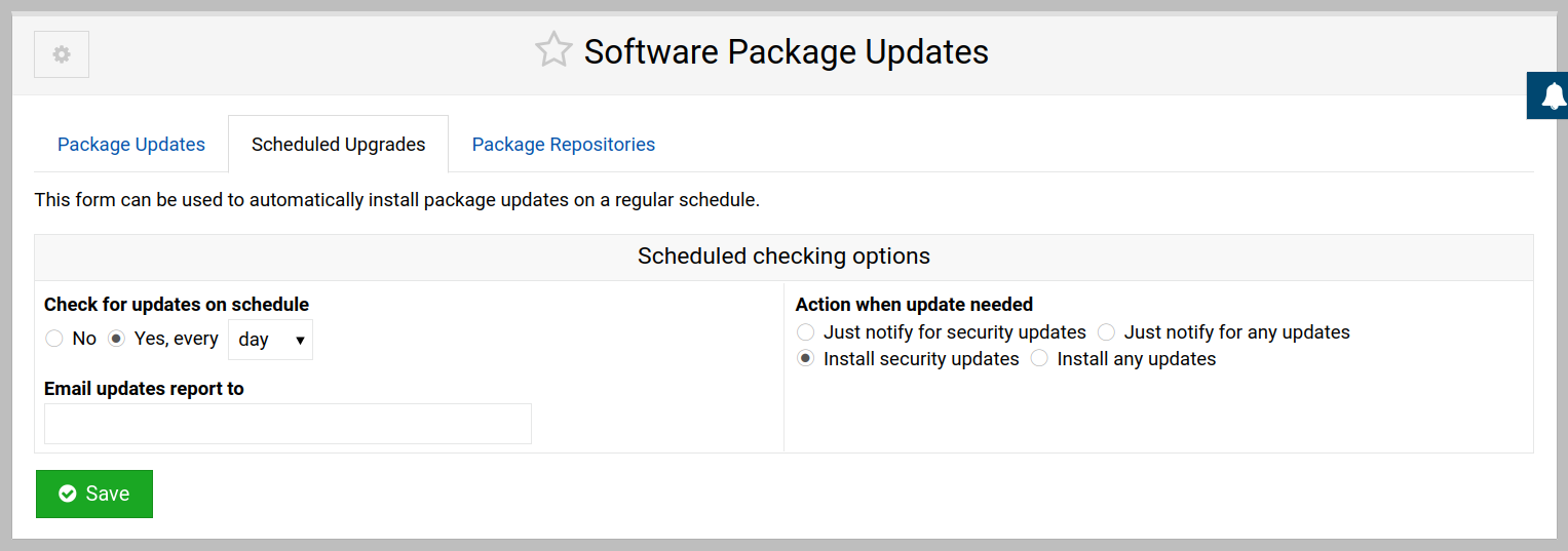

Hi there, I would like my system to obey these settings for automatic updates:

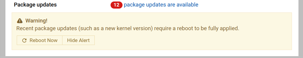

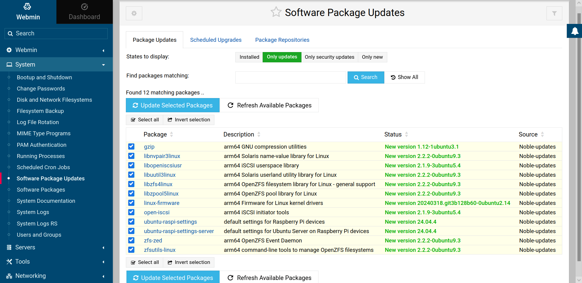

But it appears that Webmin confuses security and non-security updates from the Ubuntu Noble repositories. A few days ago it showed me these available updates:

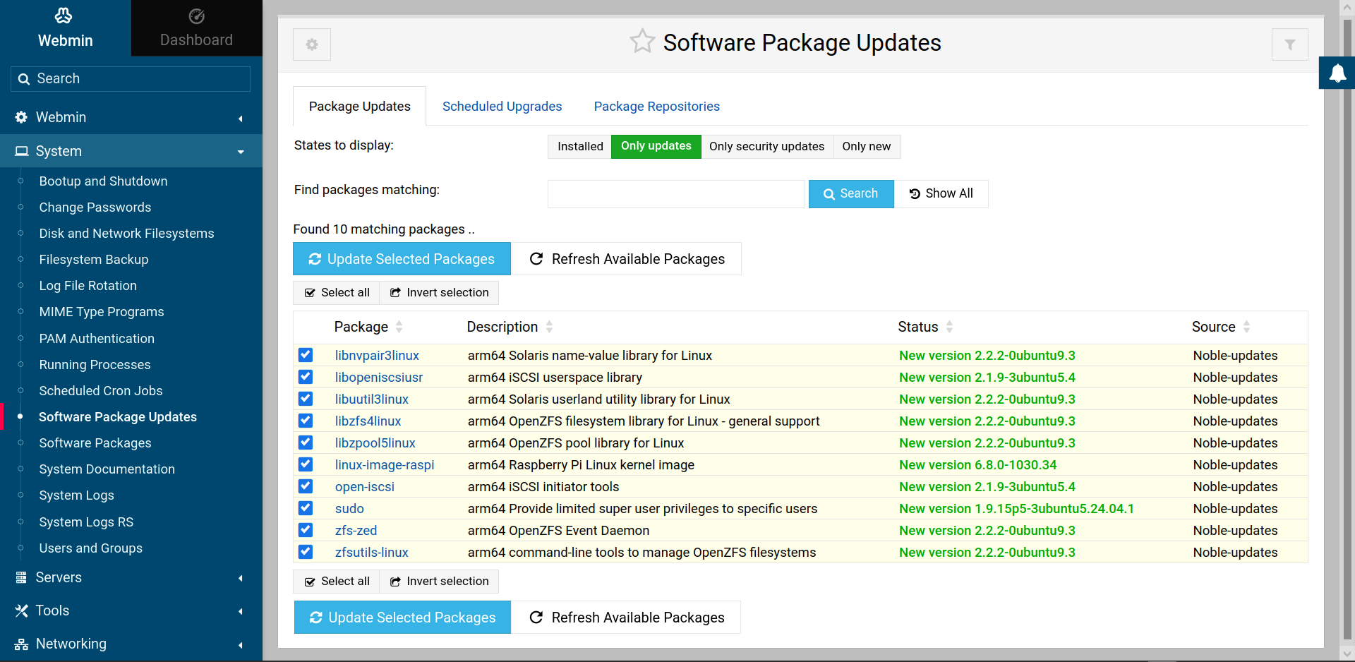

Notice that the sudo package updated was labelled as Noble-security. But then a little while later it showed as Noble-updates, which according to my settings should not be automatically installed:

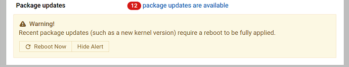

I haven’t manually applied any of those updates. But today I found this:
So at some point it automatically installed the sudo update, and it also installed the linux-image-raspi update, which according to Webmin was always shown as a non-security update.
So Webmin appears to sometimes confuse the source label of some updates, and some non-security updates appear to be getting installed. I understand that APT can pull in non-security package updates as dependencies for a security update package, but I don’t think that’s what has happened in my examples here.
Does Webmin use the /etc/apt/apt.conf.d/50unattended-upgrades configuration, or does it have some mechanism of its own to identify and install available update packages? In case it helps here’s my system’s configuration:
