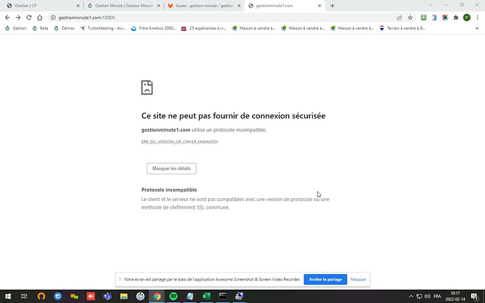

We updated and can not reach virtualmin anymore from browser. We are getting this thru Chrome (Tried from other browsers and it’s not working neither):
ERR_SSL_VERSION_OR_CIPHER_MISMATCH
I’d read another similar post but ssl_cipher_list is the same than listed and i also restarted webmin service without succes…

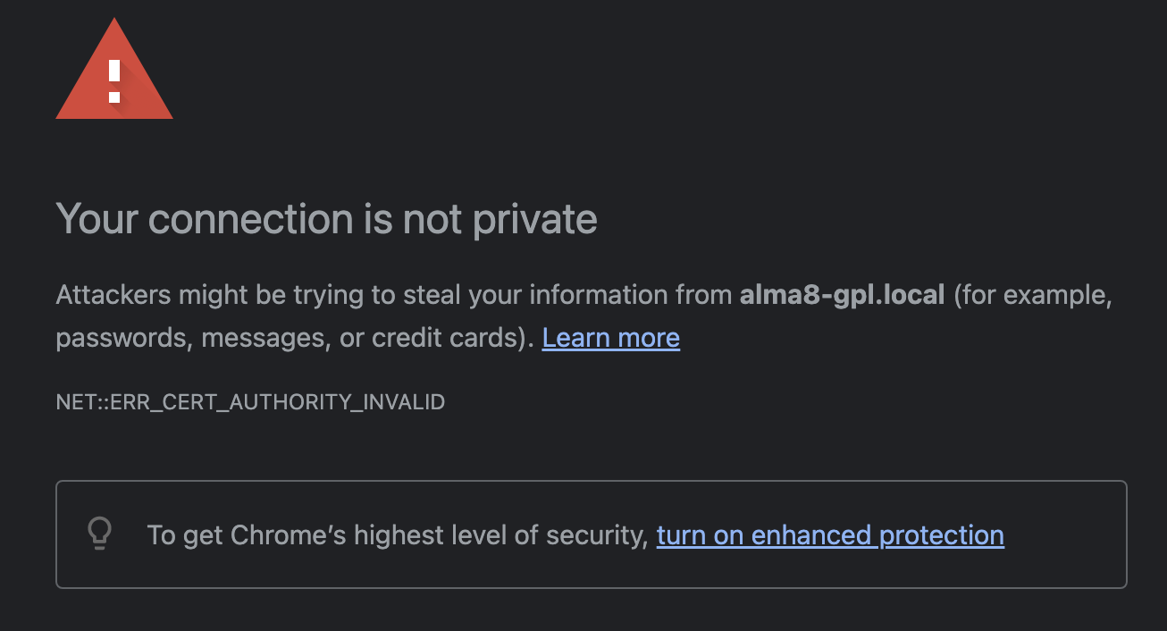

Later, as Whoops already mentioned, you can disable SSL temporarily to login and request Let’s Encrypt SSL certificate. Although, this is not secure. There is more secure work around though. Either use some other browser, like Firefox or type in Chrome when you see this SSL error message thisisunsafe and that will take you directly to login screen.

It is not used with the link. You start typing thisisunsafe when you see a certificate error screen:
Please, can you explain where i need to type ā€œthisisunsafeā€ ?
Nowhere. As this page appears just type it … as long as the page focused it will work …
After many tries, i’ve been able to get it working.
In webmin configuration settings, ssl version 10 was indicated by default and this was the problem.
I just checked ā€œDetect automaticalyā€ and it worked…
So, i dont know what value it represent in this miniserv.conf file (maybe this eval_package=) ?
I dont see nothing about ssl_version…
