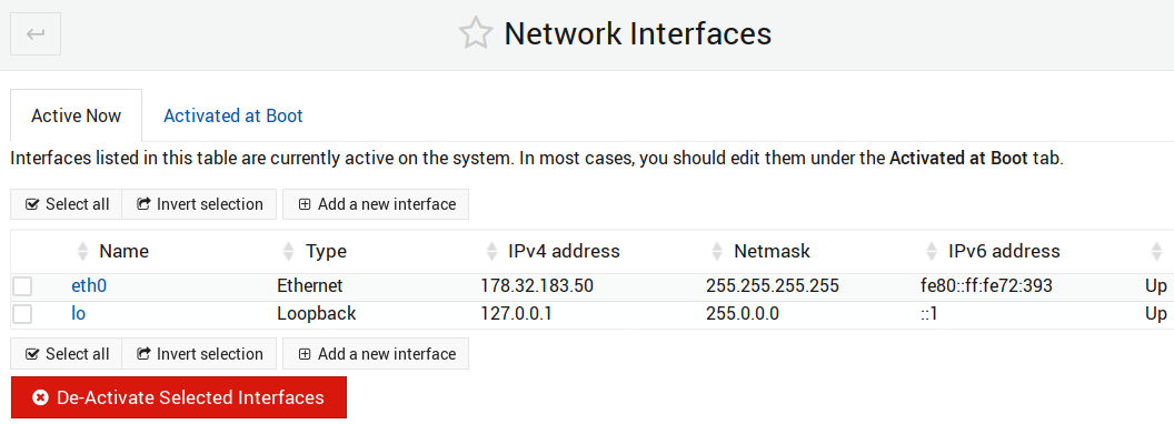

sorry, active interfaces give this :
Seem normal ?

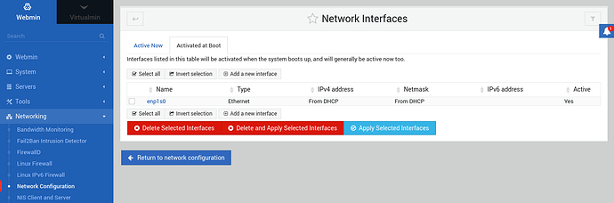

You would need to click “Add a new interface” button and set it up.
now it works
but before it was NOT possible to “add a new interface” in the VM Ubuntu 20.04
simply because, without ANY interfaces, I cannot access to the Virtualmin web site…
So, I must first define the interface in NETPLAN in CLI with VI, apply the new settings, and now, YES I can access to Virtualmin “myserver.be:10000”.
