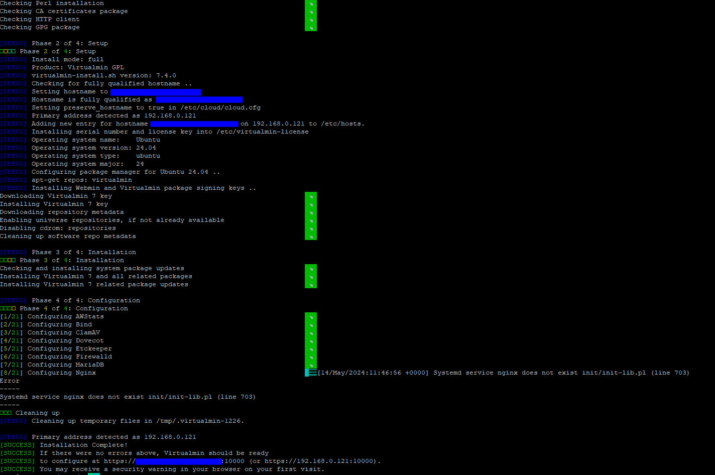

I’ve attempted to install Virtualmin with the LEMP bundle on a fresh Ubuntu 24 system, but encountered the following error during installation:
Systemd service nginx does not exist init/init-lib.pl (line 703)
The installation is complete, but I see the LAMP stack instead of LEMP as a result.
I’ll have to take a look at it over again – I didn’t see this issue last time I was running my tests. Can you provide a screenshot of an error?
I’m also seeing this! @Joe, I think there is a bug in stack packages build. Could you please check?
