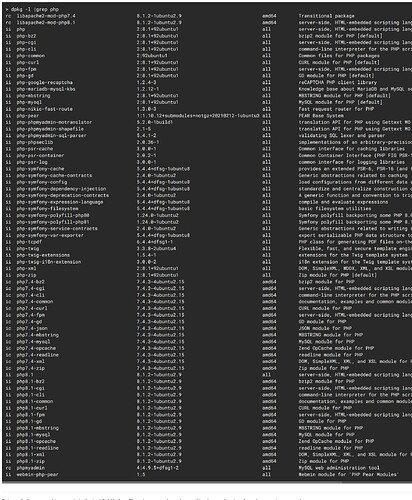

I decided to look at the loaded packages next:

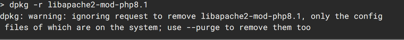

Then I decided to try libapache2-mod-php7.4 and lipapache2-mod-php8.1
then just to check–I only listed the relevant snippet.

The config files that are left laying around are the cause of your problem, by the way. A purge probably would clean them up. /etc/apache2/mods-enabled/php* is probably still present and still breaking things. Everything in etc is considered a config file by dpkg, so when you remove a package it tries to protect those files…but, the config files bundled with the mod_php packages are harmful, and leaving them continues to cause trouble (they configure Apache to handle PHP files in a way that prevents any other execution mode from working). But, you obviously did have mod_php installed (rc indicates they were removed, but config files remain).
