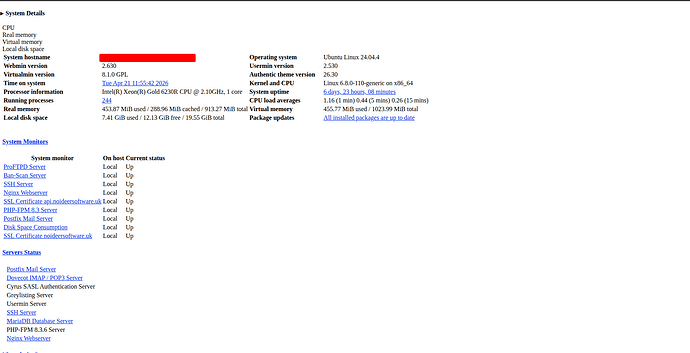

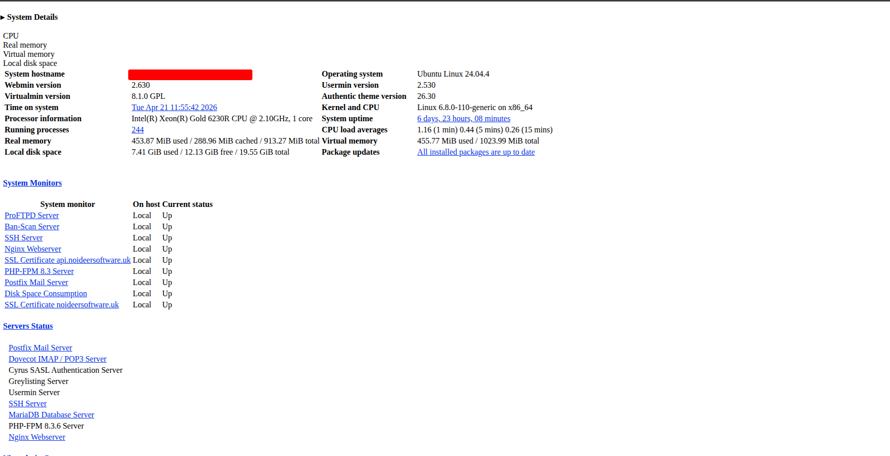

as you can I lost all css, and also the favicon ! no real biggie as pressing f5 cured the css issue and returned the favicon
note: this a browser tab that has not been touched for over 24 hours, would inactivity cause this ?

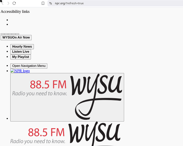

I’ve seen this issue before but really don’t remember which browser/site/etc as it is various combinations. ( I do remember Slashdot on a fairly locked down Firefox recently though.) I just reload and move on. Debian 13 but I doubt that makes much of a difference.

Ok when it fails no browser shortcuts and/or right clicks work, but looking at the server processes using ssh/htop, when the ‘browser’ goes into a failed state there is a process that is topping out the cpu(s), in fact the cpu usage grows to over 100%. The process that is consuming these resources is /usr/share/webmin/session_login.cgi rather than refreshing the browser, if you restart webmin the cpu usage drops and the browser page returns to normal after a while. I guess this is unrelated but I thought I would add the observation
