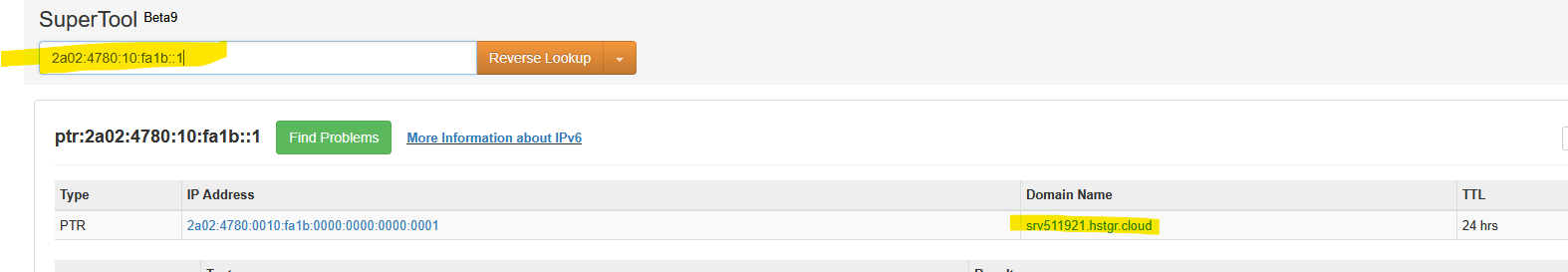

hum no, my IP server is an IPv4. If I check the lookup of the IPv6, it’s the one from Google. I guess their smtp server.
not by the error, check your mail log file and see if you see it being used.
They use a IPv4 if you use IPv4.
This ip, do you recognize the reverse domain?
that’s the domain of the VPS. Is there a configuration in Virtualmin to use the IP instead? if the issue comes from here..

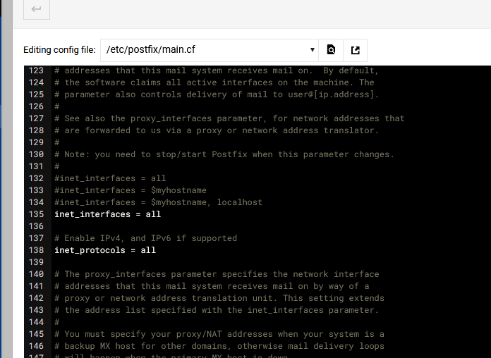

What I have to do with the Postfix config?
I use to have a Ipv6 and the connections to gmail use to circle between ipv4 and ipv6, so you probably finding some emails will connect and some will be rejected.
Like the article says change inet_protocols = all to inet_protocols = ipv4
once changed restart postfix and see if the email to gmail works.
Else you may find adding the ipv6 address into the SPF setting may resolve the issue as well. The error doesn’t seem to indicate that though.

I will try to change the Postfix setting for testing.
this solution seems to work! Thanks a lot! :slight_smile:
Is there a different to leave this setting like this instead of “all”? I never changed this setting before I think, it was by default when I have installed Webmin.
