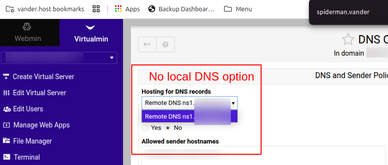

Please give me some advice. After switching from Pro to GPL and back to Pro, we’re unable to use the local DNS provider anymore:
The cloud DNS provider with the local identifier isn’t supported in Virtualmin GPL
We’re definitely on the Pro version.
We would like to move away from Remote DNS server back to local server.
Any tips @staff ?

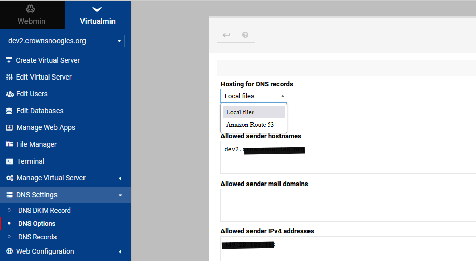

In each virtual server have you selected local?
Thanks @stefan1959 for the reply.
This seems to be part of the problem, no local DNS option anymore.

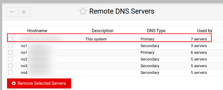

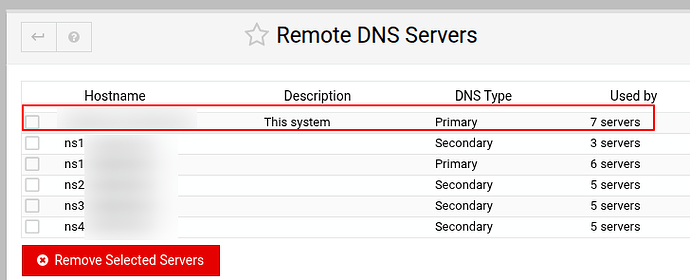

@stefan1959 wow okay thanks your reply stimulated me to look again, and then when I looked at my other Pro systems I noticed the following was missing:
So it appears I had a missing entry for “This system”!
Thanks problem solved!
