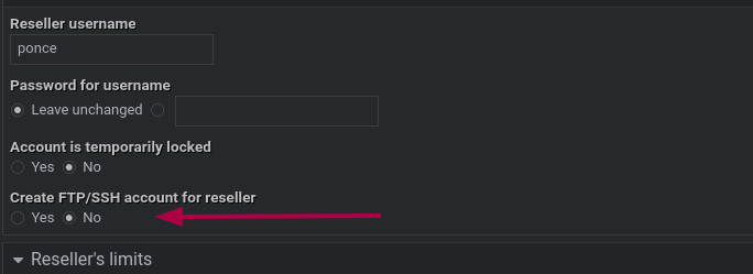

I see what you mean, are you using the reseller account as a extra administrator. This is either a oversight or a reseller isn’t meant to have terminal access.
A reseller account doesn’t have a real system user, thus can’t use the terminal (which is a system login). It’s probably possible to create a system user with the same name, though, and grant them access to the Terminal in Webmin Users.
But, you’re probably expecting them to have access they won’t have. The terminal would have user-level permissions, and the domains the reseller manages will not be owned by or in the same group as the reseller, and so the reseller won’t be able to do anything with their domains content. You’d need to…do something else. I’m not sure what the right option would be. Maybe add all the domain groups as secondary groups for the reseller. As long as all the domains files are group writable, that’d work, but also has some potential risks. Linux has finer-grained access control in a variety of ways, which might also be an option.
I got the reseller to have terminal if you edit the webmin user add terminal
That added the terminal icon and access to root.
I did also enable unix user for reseller, not sure if that made a difference.
UPDATE I can’t see any new unix user.
