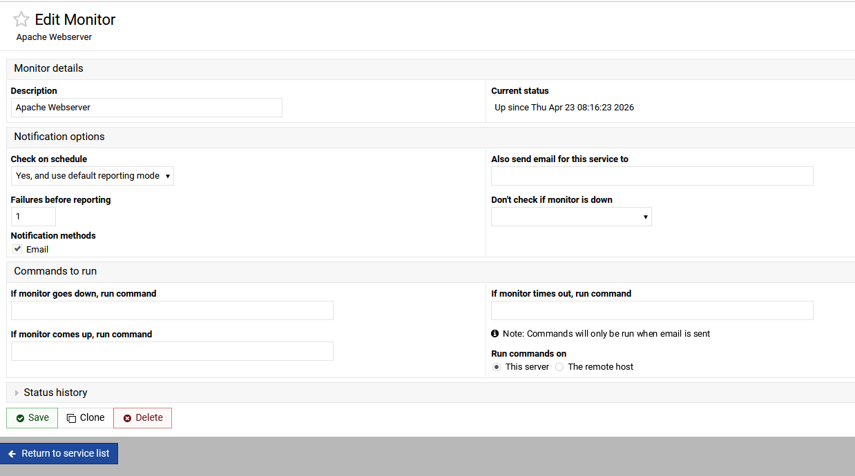

So currently you can setup a Monitor for a service and when it fails send an email or run a command.
So I can potentially configure a command to restart the service if it fails using If monitor goes down, run command but this requires that I know the command and for each of these services I want this to happen I also need to know the various commands, maybe apache2 restart or restart apache2

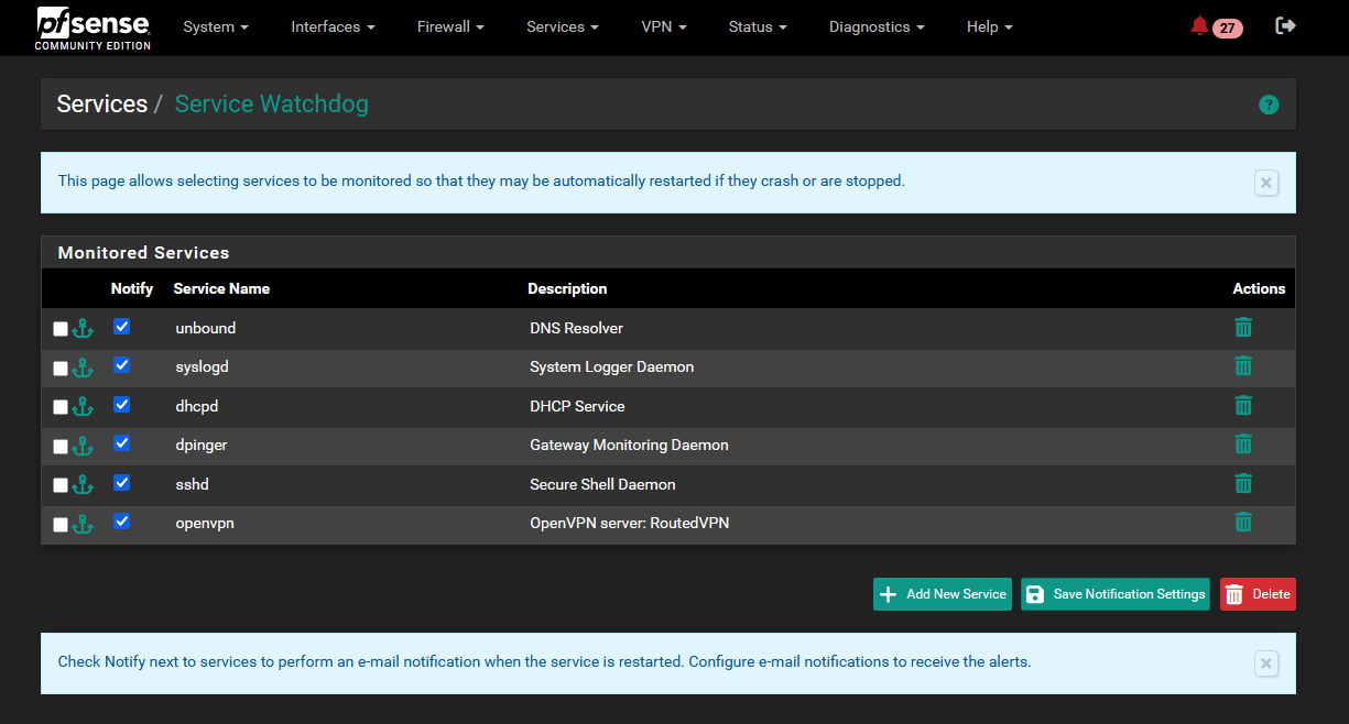

what are peoples thought on having an option that can be enabled in the monitor like the pfSense watchdog plugin. It a service is down, then it restarts it.
You could change the If monitor goes down, run command to have 3 options
  • do nothing
  • restart service + [max No. of retries]
  • freetype box as now called run this
Maybe there should be a limit on how many times a service can be automatically restarted in a row?
