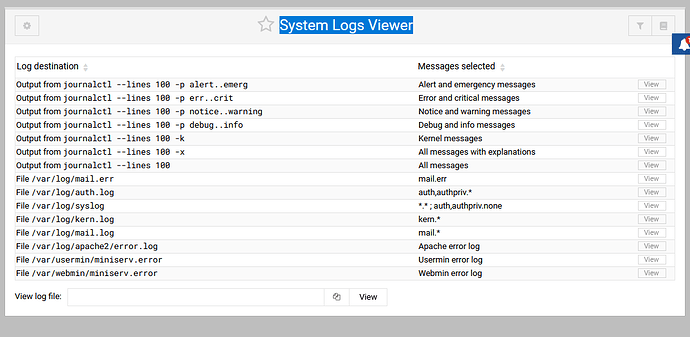

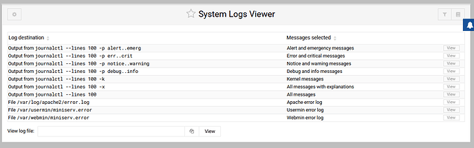

My dev site has more logs in the System Logs Viewer than my live site and My fresh install server (4 weeks ago ish)
Dev Server

Live site

These are missing
  • File /var/log/mail.err mail.err
  • File /var/log/auth.log auth,authpriv.*
  • File /var/log/syslog . ; auth,authpriv.none
  • File /var/log/kern.log kern.*
  • File /var/log/mail.log mail.*

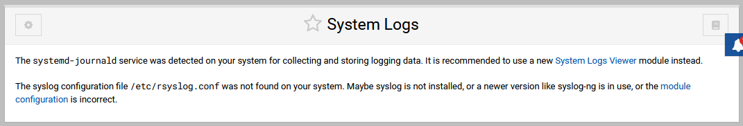

Try using Refresh Modules. Maybe it’ll figure out you don’t have rsyslog. I think it just checks for the config file, and if one doesn’t exist, it’ll be considered unused.
@joe thanks your help is always appreciated.
the refresh module idea did not work, but I am going to have a play tomorrow and when I get it fixed will post the solution.

These aren’t missing – it’s expected not to have them, as journald doesn’t have those logs.

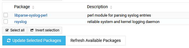

Did you perhaps install rsyslog package manually?
I don’t remember installing anything, not saying I did, but I probably saw the module and clicked and install button.
This is only my dev site, so nothing is lost.
But I wonder how it happend.
I will look to see if rsyslog is installed.
Also I am sure I have been using some of them via the view button. I will add further information tommorow.
I didn’t install it manually but it is present on my dev site with both log viewers.
It is not present on my live site
I will uninstall rsyslog and see what happens

the new System Logs Viewer is missing these (I can add them manually) but I think they perhaps should be part of the default. I do miss the mail ones as it is helpful to diagnost mail only issues.
  • /var/log/auth.log
  • /var/log/syslog (not sure what this one is for)
  • /var/log/kern.log
  • /var/log/mail.log
  • /var/log/mail.err

  • on my live site these log files do not exist.

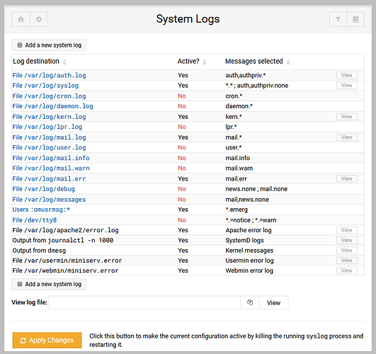

For reference

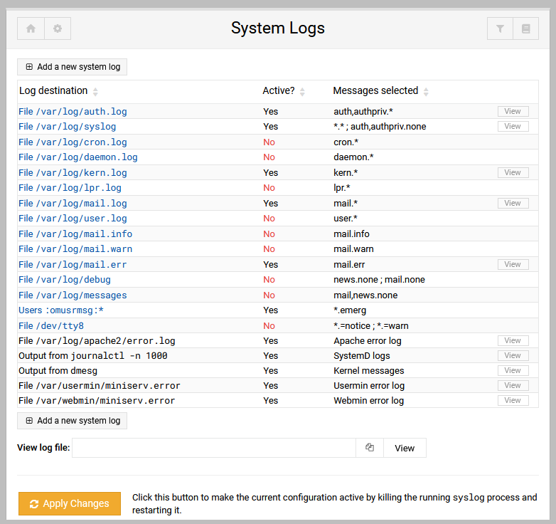

this is the System Logs page from my dev site

Ubuntu 22.04 should have both modules working, i.e., System Logs and System Logs Viewer, because rsyslog is still installed by default in Ubuntu 22.04, and it’s a systemd system.
The only difference between my virtualmin installs linux wise is that I will of used a slightly different point release of ubuntu when I installed, all 22.0x.x
I always use ths minimal server version.
According to this thread it looks like Ubuntu are moving away from rsyslog and focussing on Journalctl so it would make sense that it was removed between point releases.
  • The minimized image does not contain rsyslog. Your experience is expected.
  • You are right that journald is still installed as part of systemd. The /dev/log file has pointed to journald for several LTS releases now. The default settings for journald include ForwardToSyslog=yes, which is why rsyslog still processes logs when installed.
Conclusion
System Logs module is not present/used because rsyslog was never installed and I have one virtualmin setup with and 2 virtualmins without rsyslog because Ubuntu have removed it from the default minimal server installer.
NB: the 2 without rsyslog were made after the one with.
