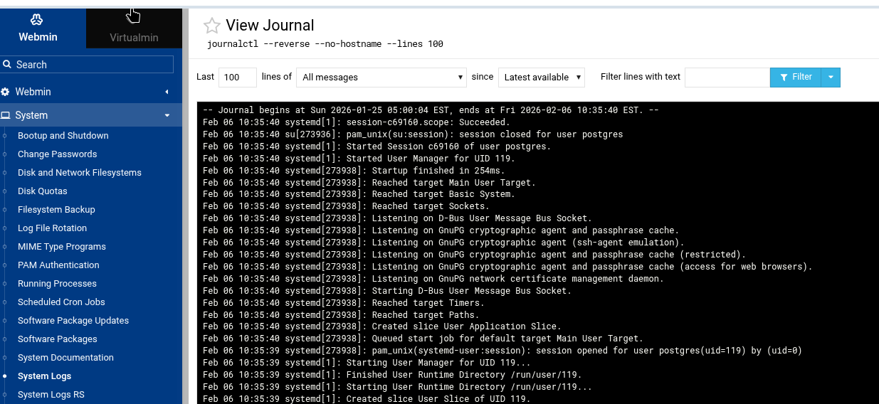

The interface provides a convenient cheat sheet.
Note right under “View Journal”. Work out what you are looking for there and just put it into a terminal. That’s kinda been what I’ve done until I learn more about ‘journalctl’.

There is a long list of things in the drop down, including postfix. But an email ID is a good filter for what you are looking for from the sounds of it.
