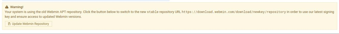

Today I’ve found a notice for a required upgrade of the Repository-URL:
If I click on this button, the page reload and I see a spinning loading-indicator in the upper right corner of the message.
But if it disappear and after reloading the page, the message still appear.
Any Idea how to check and fix this issue?

I wonder if there is a way to set this new URL manually to fix this.
Yeah, it can be easily fixed. Although, at first can you see which APT config repo files have webmin.com set, e.g.:
grep -Rsi webmin.com /etc/apt
Also, show the content for the files that contain webmin.com strings.
# grep -Rsi webmin.com /etc/apt
/etc/apt/sources.list:deb [trusted=yes] http://download.webmin.com/download/repository sarge contrib
/etc/apt/sources.list:# deb-src https://download.webmin.com/download/repository sarge contrib
Binary file /etc/apt/trusted.gpg~ matches
Binary file /etc/apt/trusted.gpg matches
You want the entire content for /etc/apt/sources.list? Or what other file?
I’d suggest to just remove all lines that contain webmin.com in /etc/apt/sources.list, as you should only use Virtualmin repos.
If you wanted to have Webmin repos as well, you could use Webmin setup-repos.sh script to setup repos in the right way.
We will also change Webmin fix_repo.cgi script to handle all various formats.
Thanks for the heads up!
