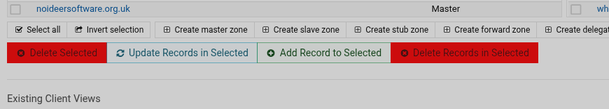

I did the danger buttton to look like this
with this code
.btn-danger {
    color: #161010d6 !important;
    border-color: red!important;
    background-color: red !important;
not too difficult to do
