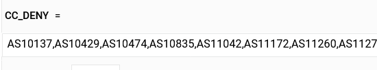

You should open the ConfigServer & Security Firewall configuration page and carefully read through the options’ descriptions. There’s also a link to the documentation on the module’s main page.
