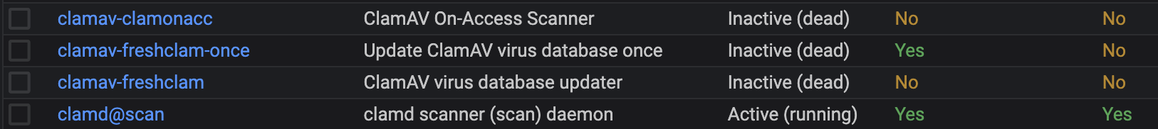

I assume this is all as it should be too (particularly the on-access scanner piece?):
clamav-clamonacc is unrelated to email. clamd@scan is the scanner used for email.
And, your version is well after that specific packaging bug. I’ll have to pull up a Rocky 8 box and see if I can see what it’s supposed to be and maybe what went wrong on your system.
