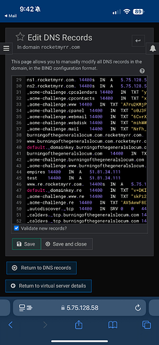

This points to a DNS problem. As you stated, I got to the main site fine. Can you screen shot this. It is a little safer than a cut and paste in terms of bots I guess. Not sure about that anymore. :frowning: But most of this stuff is public info since it is DNS. You can delete it soon enough regardless.
In this case, forum.brewforge is a sub server of brewforge. Subdomain in cPanel speak. :wink:
Sure.
Note NS2!

Note lines 8/9 in my screen shot. I’m not going to suggest you do any manual editing of the files. The fact VM won’t add it because it doesn’t see it troubles me a bit.

Also, even though I see ns2 in the screen shot above, I can’t even do a dig of it at ns1. Kinda makes me think the glue records are borked.
