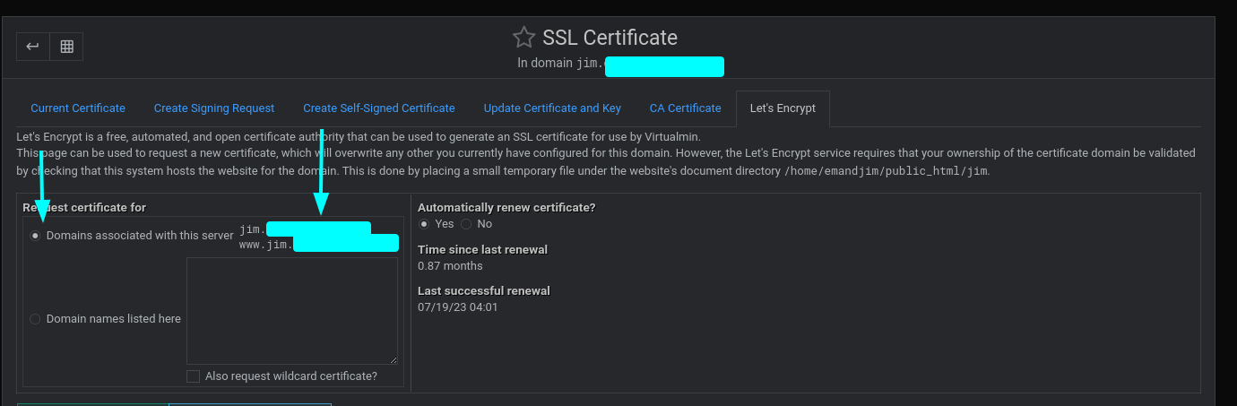

is also using the wrong certificate, both in fact are using the certificate for 32yo.com easiest answer is to request certs through the sub servers (test.32yo.com & wiki.32yo.com) ssl certificate management pages virtualmin :arrow_right: server name :arrow_right: server configuration :arrow_right: ssl certificate :arrow_right: lets encrypt and request a certificate for each, so a real world example is
virtualmin :arrow_right: wiki.32yo.com :arrow_right: server configuration :arrow_right: ssl certificate :arrow_right: lets encrypt
This assumes you have create the sub servers using the virtualmin module, if you have created the sub domains a different way (created the virtual server outside of virtualmin) this will not work & you will have to manually request & install the certificates
The page should look like this
