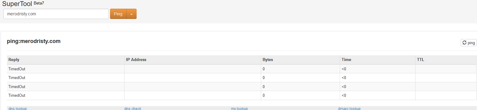

server down?
ping was disabled. I have enabled it. I am using AWS Lightsail.
