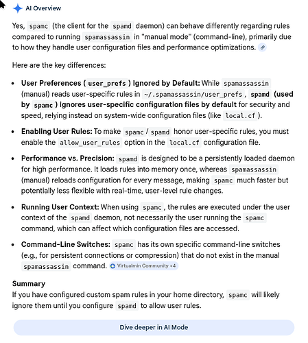

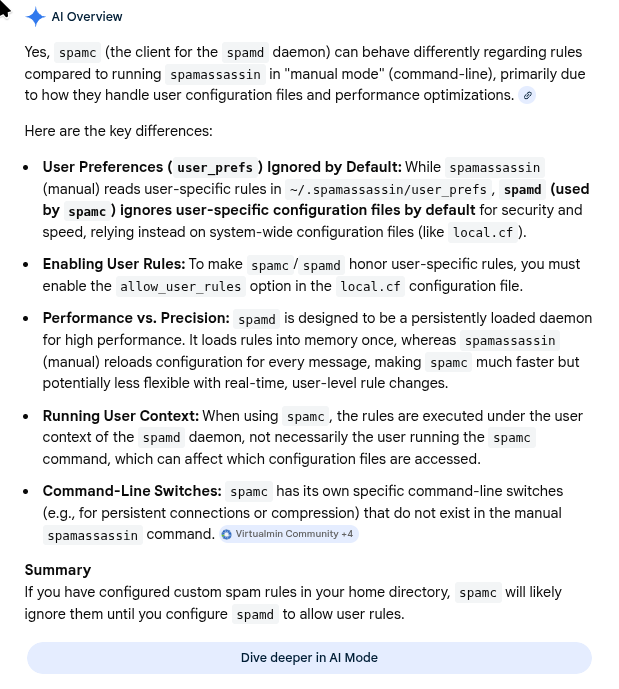

I haven’t finished my morning coffee yet. However when doing a quick search the Built In Scrupple AI offered up this. I’ll include the search string so others can search it and the output. Seems reasonable but I don’t have time to check it myself at the moment. IF it is wrong, let me know so I can delete it as not to pollute the forum. Though, if you look at the very end it appears the AI is quoting this forum. (Well looks like a Virtualmin forum summary and doesn’t paste cleanly . Interestingly enough if you ask for ‘deep dive’ it says NO instead of Yes. :rofl:)
does spamc use different rules than manual mode
The only way I can retain the formatting so it doesn’t get ugly is with a screen shot.
Interestingly, there were about 2000 emails in the sample directory, of which about 80% were actually spam but had entered the inbox. However, almost all of them were identified using a manual script, but we want this behavior to be standard at the server level.
Check #2 Bullet Point about enabling user rules. It should be easy enough to verify. That’s why I posted it. I STILL haven’t finished my morning coffee and started breakfast. :wink:
