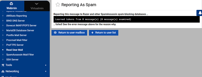

reporting spam gives error

It says 0 messages, you did tick a message

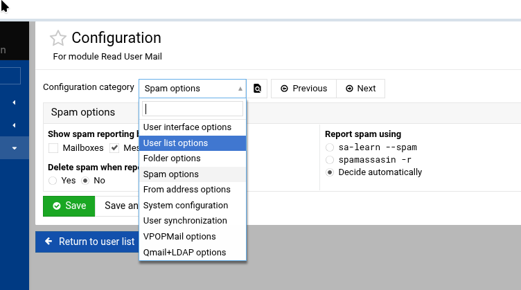

I think that is inherent in the process. I’m on Debian 11 and it works. I think SpamA has its’ own logs so you might check there.

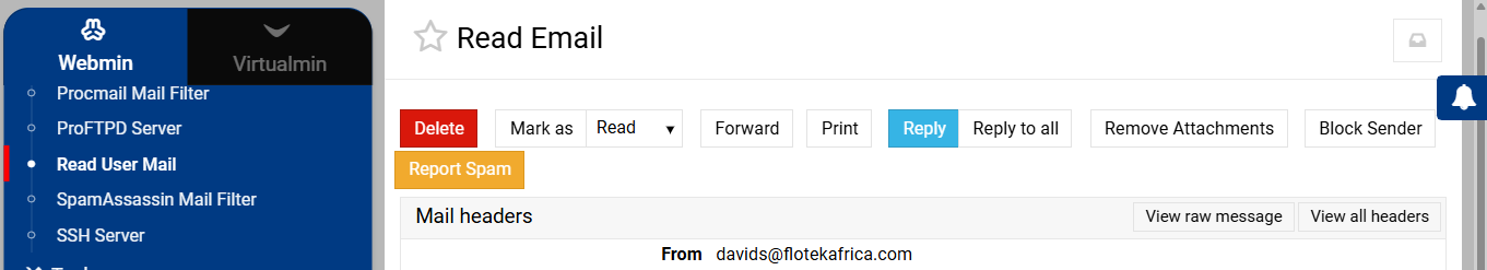

hi stefan i did opened up that email click report as psam but i get above error

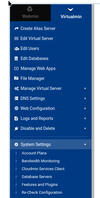

You could try running RE-check Configuration I guess.

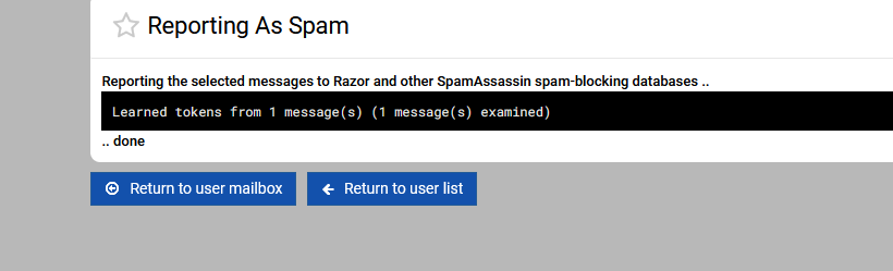

Yess seems this step worked for me
Strange but as long as it worked
