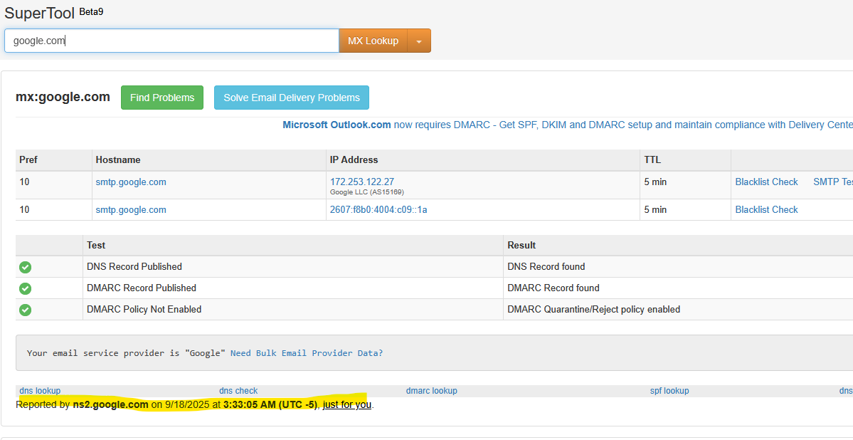

I have changed to a -all record and tested using a different “service” https://www.mimecast.com/products/dmarc-analyzer/spf-record-check/
and the record still Fails
Screenshot 2025-09-18 100219
Annoying when this all used to work :anger_symbol:
