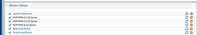

Webmin has a simple way of checking if the server is running.

Ok I found that screen and it says my PostFix is running so that’s good!! I don’t think it’s about my hosting provider because I was able to both send and receive a couple days ago before a different reinstall that I did trying to fix a different problem. I’m using a VPS through Contabo, I’ll check their documentation though to see if they mention it.
