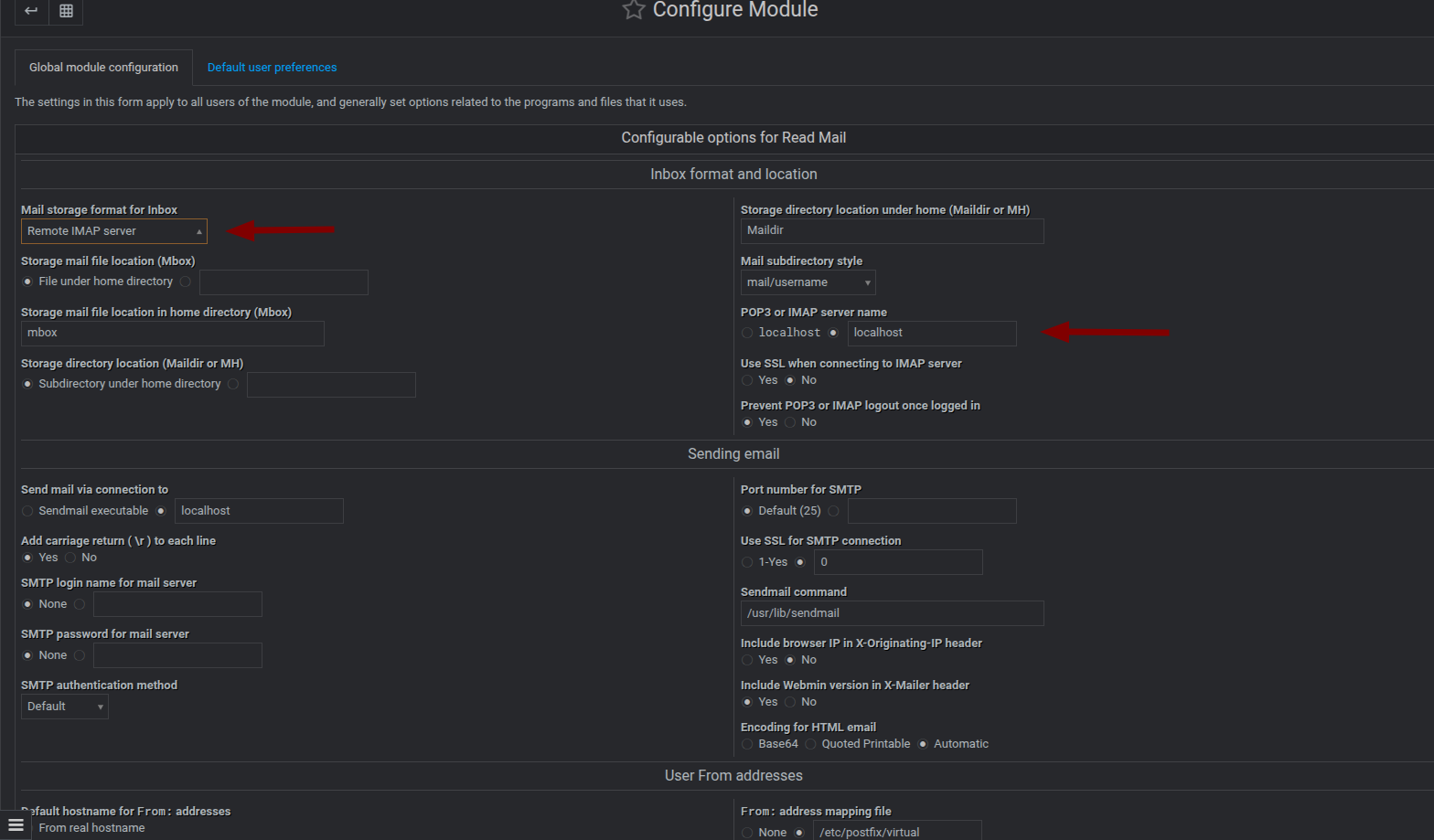

Hi Joe,
Could you please provide guidance on how to configure Usermin to interact with mailboxes via IMAP? I’ve looked through the Usermin configuration and module settings but haven’t been able to find an option for enabling IMAP. Any help would be greatly appreciated.

not quite
try webmin-> Usermin configuration-> Usermin module configuration->readmail
you will see

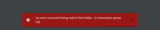

Just tried this option. Its the mail storage format which doesn’t help to read emails faster. This option doesn’t load the mails even after 5 minutes of waiting.
Also after waiting for several minutes with option “Remote IMAP Server” for mail storage I get this error:
I’m thinking you have something else wrong … have you tried using Outlook, Thunderbird or gmail to access the mailboxes ?
Yes, I have. I’ve been using thunderbird and gmail - no problem at all.
