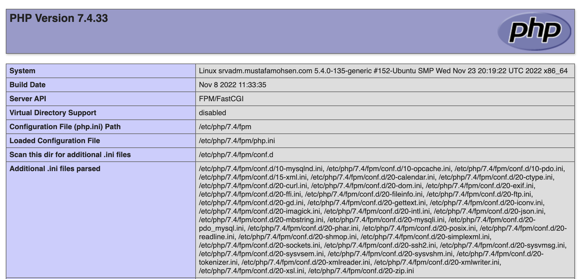

Now I noticed something. I tried <?php echo exec('whoami')/ ?>, which oddly outputed www-data rather than the designated user, which is set in Services->Configure Website->Users & Groups. How comes? And how should I fix that?
You’ve installed mod_php. You should not have.
Isn’t it disabled here?
Now I found in phpinfo that it loads the global php info rather than the virtual server’s one. How do I fix that?
I believe that’s part of the chaos that mod php creates and why it should never, ever be installed.
I only know of two ways to fix it, so you might want to wait and see if someone else weighs in with a better solution.
Option 1: obliterate the server and start over.
Option 2: go to your file manager to top level, search for php.ini and change the values in every single one of them. You’ll probably have 6 or 8 different ones at least, located in different places. Change the values to what you want in all of them, then restart your services.
The same answer. You installed mod_php, and should not have.
Uninstall mod_php. It is usually in a package called just php or phpVERSION-php.
There is no reason to have mod_php installed. Literally none. Just uninstall it and don’t install it again, and this thread stops being complicated.
