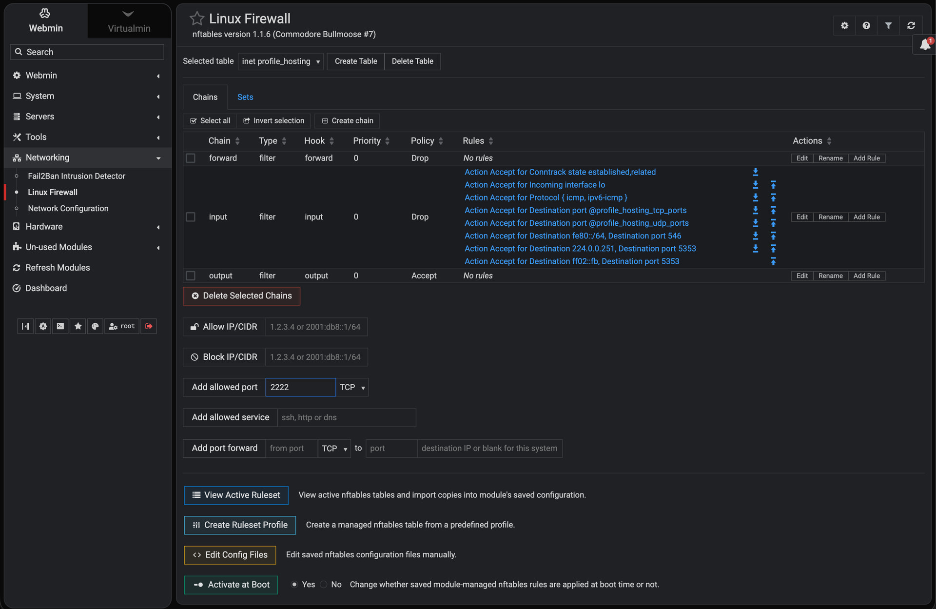

Before switching a few VMin servers from firewalld to the new nftables module I have setup the nftables module with webmin at a fresh installed debian server on bare metal.
To get the ‘internet firewall’ module active, I needed the nft utility, a simple ‘apt-get install nftables’ did the job. The predefined ‘inet profile_hosting’ rules of the new module made the basic setup easy.
As a cli addict I looked at /etc/nftables.conf to see how I could add my favorite non-standard ssh port. No real setup there, just an empty ruleset. The real nftables setup happens to be in /etc/webmin/nftables/rules.conf, not in the standard location.
Why is the standard location not used?
After I inserted the not-standard ssh port with the webmin module I tried to find a button for a reload of the firewall rules. Could not find that, there was no automatic reload, the extra port was still blocked.
A simple ‘systemctl restart nftables’ did the job. EDIT: this was not correct, all ports were open now.
Can we have a reload button? Or did I miss something and should a reload not be needed.
Great to have this new module, thanks.

@Ilia, that page looked promising to me, however I missed a button to close port 22 and made the changes with the edit button on the Sets tab. More details below after some extra tests.
I did the following:
Open the Sets tab, click the Edit Sets button for tcp ports, remove 22 and add a new nnnn port.
After that was done, the new situation was not active. Port nnnn still closed and port 22 open.
To activate the new rules I tried the usual ‘systemctl restart nftables’. This switched off the firewall, all ports were open now.
What happens is that after a reboot the settings settings stored in /etc/webmin/nftables are active, and that after a systemctl restart, the settings in /etc/nftables.conf are active. For a firewall this is a bit a dangerous combination.
