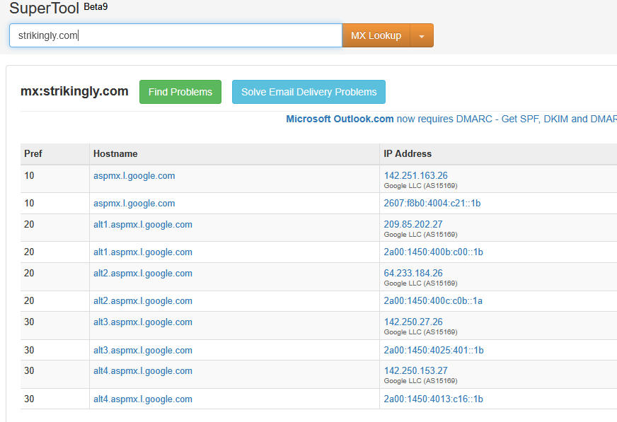

whats those setting got to to with strikingly.com, by my lookup its handled by google.

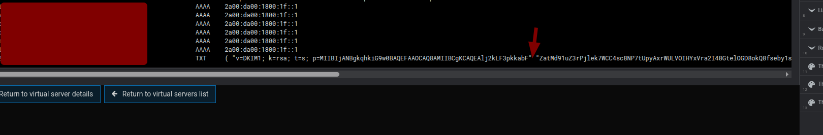

your dkim record is wrong it should be a continuous string no line breaks
if copied from virtualmin remove the arrowed sections
so
p=MIIBIjANBgkqhkiG9w0BAQEFAAOCAQ8AMIIBCgKCAQEAlj2kLF3pkkabF" "ZatMd91uZ3rPjlek7becomes
p=MIIBIjANBgkqhkiG9w0BAQEFAAOCAQ8AMIIBCgKCAQEAlj2kLF3pkkabFZatMd91uZ3rPjlek7do that all they way through the p= section
I’m confused about what you’re trying to do. What does Strikingly.com have to do with your email or any of the records you’ve shown?
If you are not hosting DNS on the Virtualmin server, you should turn off the DNS feature. Then Virtualmin will offer you a page of “Suggested DNS Records” which you can copy paste to your actual DNS servers. I can’t be sure (because I’m not sure what I’m looking at, you haven’t given us a lot of information to work with, and what we have seems misleading…I still can’t figure out how Strikingly.com has anything to do with anything), but it looks like you have some copy/paste or formatting errors in your records.
