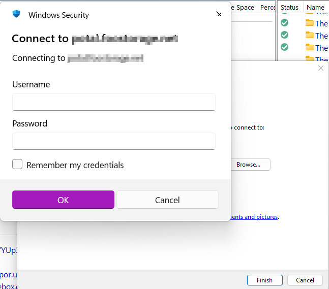

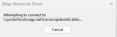

A couple of screenshots below. I feel pretty sure the Samba share is set up correctly; it’s the Win 11 that won’t connect to the share.
The mapping network drive connection box hangs for about 20 seconds and then requests the username/password again :smiling_face_with_tear:
2026-10-02 08_24_06-Map Network Drive
Any help appreciated :+1:
